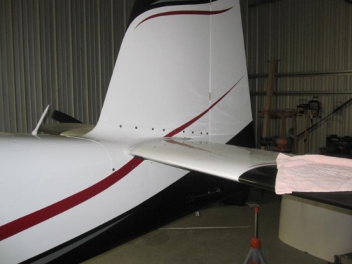

Does anyone have a slick method for creating an antenna stiffener plate for a top mounted antenna - comm #1 and ELT in this case.
Unlike my -6A, the -10 fuselage has a central stringer down the center of the tail cone and any large hole that is centered would seem to remove most of this stringer.
If I offset the antennae a bit from the center line I think the slight curve in the top surface would make them look crooked....:)
Starting on equipment selection and initial conduit/wiring installation.
Because there is a slight curve where you are mounting it, if you make a stiffener it will flatten the area above the stiffener and it will show. Ask me how I know. What I ended up doing is creating a stiffener that is fastened to each stringer, I then made shims and installed washers between the aircraft skin and the stiffener so the shape of the outer skin is unaffected by the stiffener. You will never notice the slight leaning of the antenna. The antenna is extremely stiff doing it this way

Mine is off center as well. I couldn't quickly find any pictures of the doubler, but the top is still rather flat. Yes, the antenna isn't parallel with the vertical stabilizer, but nobody seems to notice.

Thanks Bill/Bob,
Offset it is. :)
I like Bill's method, and if I put the VHF antenna mounting holes in the stringer and put the larger ELT hole just touching the stringer, the offset will be quite minimal.

I mounted the top one offset from the center with a flat doubler. No way anyone would know (much less care) unless I told them.
