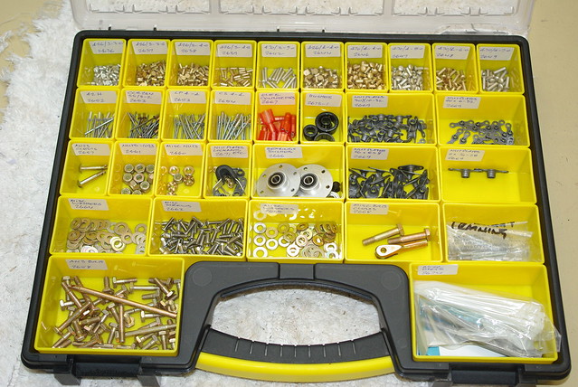

One of your most important TOOLS is this. Buy 4 briefcase size plastic sorting bins - Harbor Freight or a big box store. The kind that close like a briefcase and contain many individual compartments or removable bins. Inventory your bags of small parts and put each different part into a compartment labelled with its PART NUMBER. Do not mix parts in the same bin that are the same "thing" - like different size nutplates. You can mix different "things" like one size of nutplate and one size of cotter pin.
This method will save you HOURS.

I agree with Bill_H and DonFromTX about organizing parts in bins. I wasted days (if all the hours were added up) looking for parts. It is worth the time to use a computer to make an index of each part's location, such as cabinet 2, drawer C4, section 1. When a part is needed, use the computer search function or look it up on a printout. If you think that doing this is a waste of time, remember this post while you are looking for parts. :D
While you are at HF, get a big variety container of cable ties. You will use more than Vans supplies you in the kit. Use the ones supplied for firewall forward as firewall forward because they are high temp. The rest don't matter.
If you organize your "briefcases" well you will not need a computer list. The plans show a screw of some sort - you will quickly learn where the screws are! You will know those cases like the back of your hand.

Harbor Freight has these suitcase-size bins on sale at this date 8 Feb. My question is which one? There are large compartment and small compartment boxes. I assume the small because of the vast variety of parts but are these small suitcase bin sizes adequate? Also, I assume if your work area has adequate space a 30 bin wall mounted rack would also be helpful, correct?
These are good:
I used the 30 bins, only about $15 as I recall. I actually bought several for later, just in case. Worth every penny. Also, scotchbrite wheel worked better on the HF buffer motor, less vibration. I also bought the Cleaveland kit for RV12. I don't want to know how hard the regular squeezer is to use, on the 1/8 inch rivets the Main Squeeze can be tough at some angles. I already had a band saw and drill press, both get a lot of use. I got 2 extra microstop countersink cages with the nylon tip (cuts down on marks) to minimize setup times. Got those from Amazon, but available elsewhere too. Bought a 2x and 3x rivet gun, just need 2x if you go that route. Look up the EAA worktable, I started with 2 Sam's club plastic top tables, they are tough but not heavy, and you can't drill into them as needed. I built mine with the plywood top and then put on a sacrificial 3/4 inch particle board top with a 3 inch overhang. They are very flat, heavy,strong, and you get a storage shelf. Wish I had started with them.
