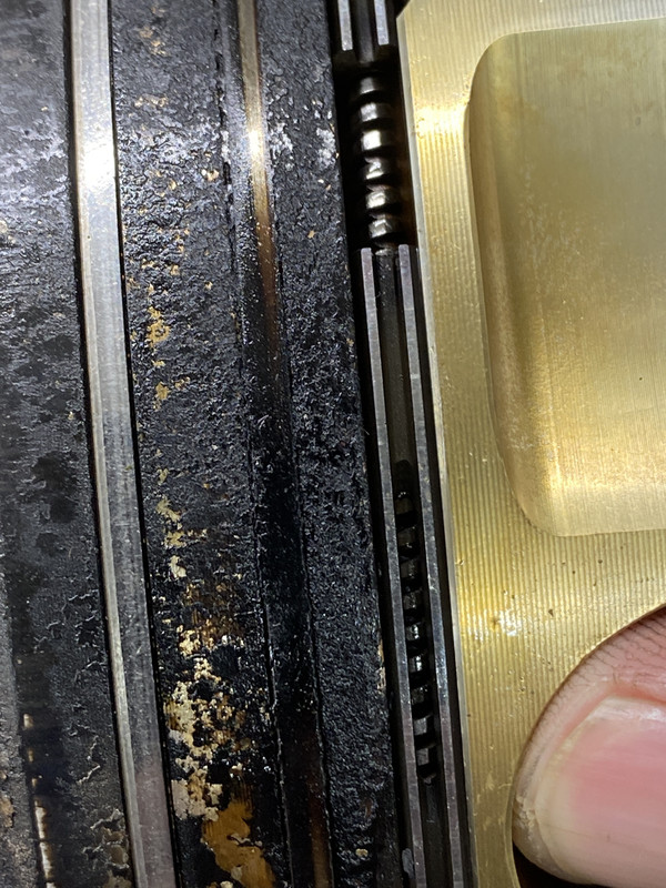

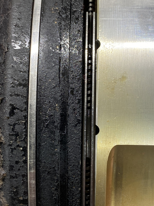

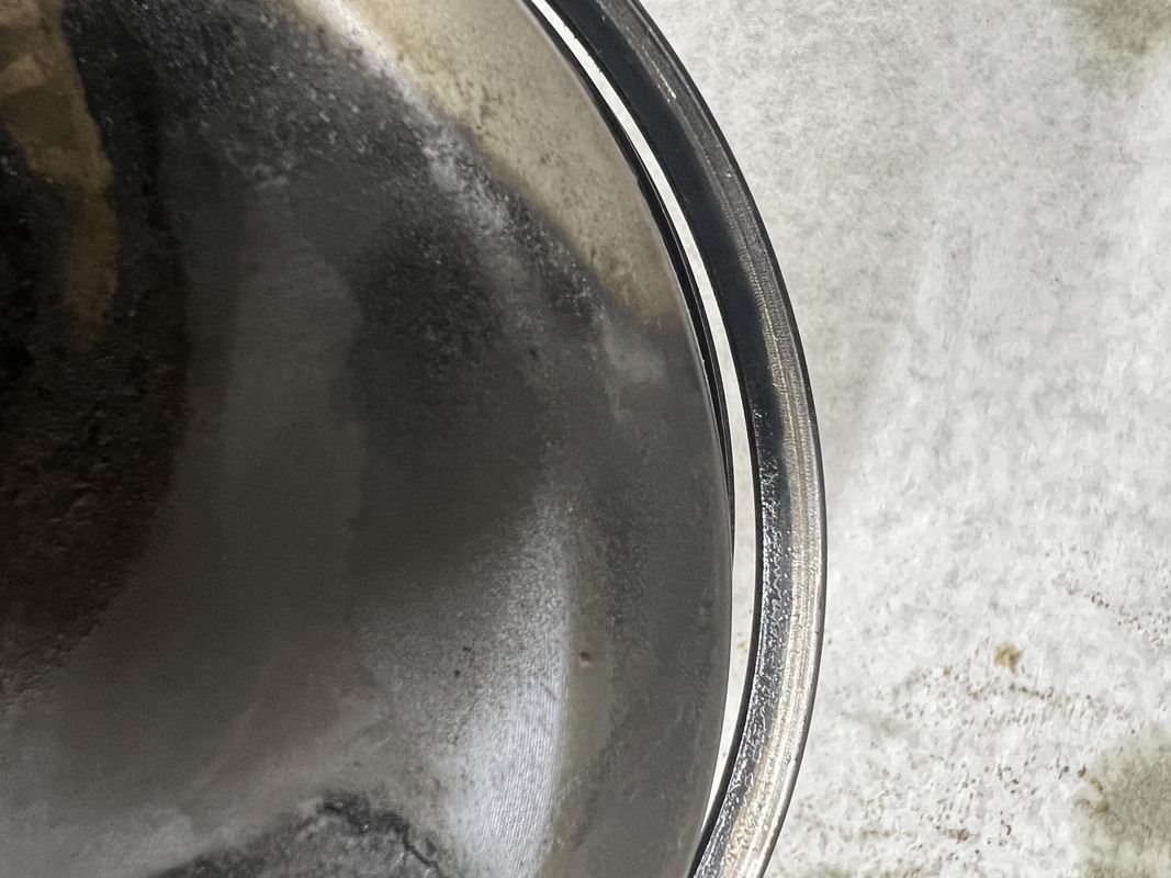

I also have a Titan in our Lancair. It's a x-340. Interesting it's the second ring, the oil control ring, that you are having issues with. I had issues with the second ring on our 340.
My oil consumption went from a quart every 5 hours or so to a quart every hour or two. Compression test showed 75+ all around. Engine was still producing good power. It had an occasional hickup transient loss of power. Strangely, when I blew into the air-oil separator I could hear an air leak from somewhere near the front of the motor, and a quarter turn of the prop would make it come and go. I still don't understand what was causing this; it wouldn't replicate when I got the plane to my mechanic.
I decided to investigate.
Still unsure of the etiology of the broken ring. I have learned there appear to be many possibilities. sudden high oil consumption is important as it was the case with my broken ring. While I don't know when the ring broke, I did see sudden high oil consumption. It changed from a quart every 5-6 hours to a quart an hour the next flight. I also had an oily plug on the #3, the cylinder with the broken ring. The compression test was 75+/80 on all cylinders in spite of the broken ring. I would suggest that a broken ring be high on ones differential diagnosis list when confronted with these symptoms. Unfortunately, the only way to know is to make the decision to pull the cylinder.

Lots of potential causes but an out-of-round cylinder (wall) will create stress cycles on the rings -> possible fatigue failure of the ring parent material. Would be interesting to examine the fracture (specifically crack initiation) surface. At least we’d know the failure mechanism.
Air cooled cylinders present a more unique challenge than their liquid cooled counterparts. There’s a relatively significant ant amount of barrel choke. There’s only one operating CH temp where the cylinder walls are truly straight; not an easy target for an aircraft engine’s environmental operating envelope. This makes it more intrinsically intolerant of design, quality, whatever, issues.
