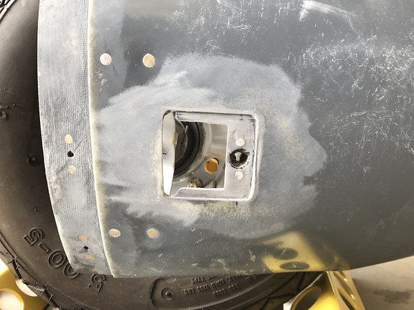

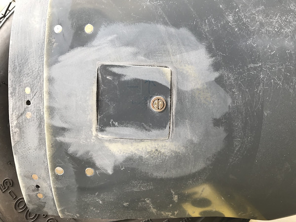

What he said. Laying up the doors using the pants for the shape. I figured while I’m doing glass, now is the time.

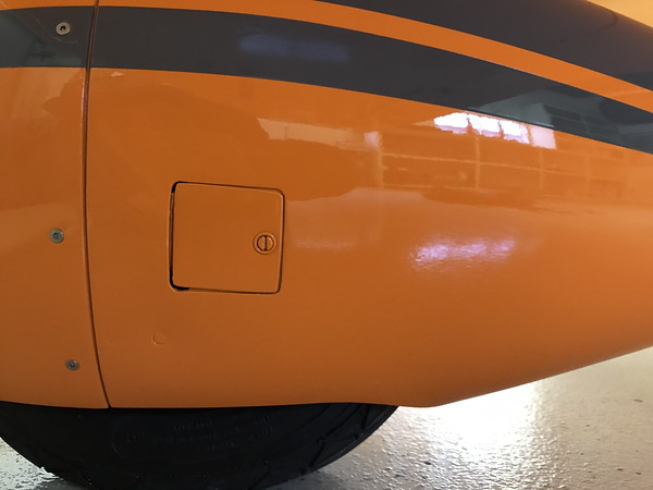

I ended up making little doors too, each with a cam lock connector holding them on.
Paint hid all my nasty amateur-hour fiberglass work:
