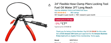

Use this tool and remove / changeout one hose at a time. Measure old hose and cut new hose to length. Take photos to verify hose routing. You can reuse clamps. Not a hard job....

The tool that Jim shows is excellent for the constant tension clamps that should be use with silicone hose. HPS, Pegasus, and a few others has pre-bent hose, with longer than needed legs. Cut to fit, and youre in business.
