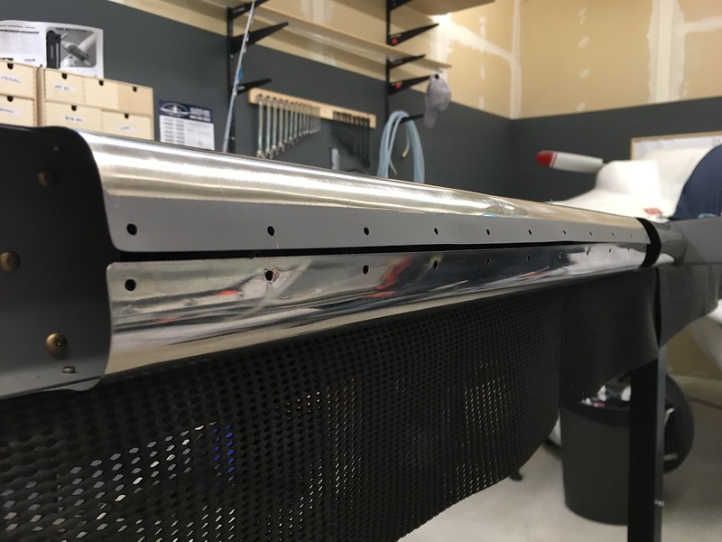

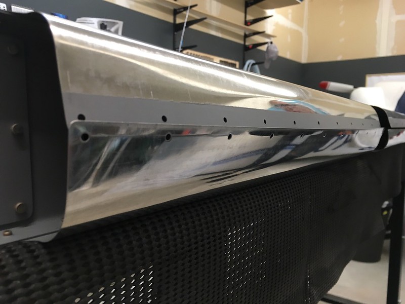

I did my rudder leading edge today; first time doing a leading edge.
Happy with the results.
Omk7VAyQreaplprL0u4klTT8LCvQ7l5tTwBnJQnMcsM3zPir5cGfQKYbwwT6jq3-OhJ_B_zd3A9Ye5zDTW1BOd4aFtNOuWXvCk5qsbjXp6ZKtcxCSYfnC-9pRCmZMUT2wrO45oy48J0ootOlGJb1ULJNXqy8Nl9HptctyDXeODA2gBWq3_x36Zr5c5sOD9lKFaML21-vnjXmNRJY5qAEQWCpXq1AsfBz5mrPVqzYBV_b0Yf0Aufp_bK1iFyDnmk4NUPJN1IPzvhKYSegFySBa-CEAEMaUVgOikwBKcu2KXloZZfCXFtZgSrcS_eEDXKecCki5I8RNU5TdPiNvX0wvCrfX8ZkfZg9ND9LYIUhP8hK982snUixZU6x0-QI4ixqlwaMXJTpG2La-iqlEaSxgcq4hJlU2v8eJhORYtJMacCAg5VWzu33wA0v-VsT11Zo3lUROwMmI_nOP78EgUVToTeiY4VWhL3IiQ9y3WLf1W2jbzqzk6ES0PWIEiq0bmW3OSDNFLodye-idBgntfUjpRfaYsBTB15pOyDdZXUd2GefPCbHMUQkOHxX6Il1xeLzcbN6=w1199-h900-no
wS83HGbkX734s7k6UPNlkEYVbxo8c38eFLC0h7pJ3VQHhhnLCXWzLXbGbGJjs1iRztwNcIvuAGPHjowBQGUa9huwfqTWwL406VnIc_ybwcAnvsAx7hZd0ujQTkolB8iIYKsAE92Z1tNjBITqjoaKIyvsSQjChsrQhJnJ7cOqbjmHew7T5lfTZbMNdmo9I1gSioghXBuQvOMs03hkY4zgxIaVYRRpIEez_8rl6wHeNVNGVQ1xhIxpxdp4XHbSKmkUgjPhzWxt8wLXPZPXgwsh1OysLu41-kGOh46pdrF-A7pN7WxIv5zSIMFsVQKKkcQrR9XUnUTzk6BtsEIH7PmFwUn0Q7CZ4kRBCE2YKL61iY6Bxr8RFnBrqVKAETBgcRYVyDxvxCig3oqetdL4RnPlFgJpvtcOWdkxVOB-wWsmzs002hzDbvC8vH6JaGHAmW4lGLfiGUqG7HKjf7nW7-4si70P8I4haVYHxeHy_6lJ3mM6ltOSHSdj-_Ap644e7dCqBtEH5DZjXV2rA6Nc1GodO-3MYMYsxmUORsC-_eKrUd8qr43Qzv0Lf-1VauOYWCVCB8qL=w675-h900-no
Looks great Adam. I just finished my RV-8 Rudder. Used this method, happy with the way it turned out but I still needed to a lot of hand tweaking and massaging to get it close to where it was not too much stress on the rivets. I worked them till the skins where touching (or almost) then pulled them the rest of the way and riveted. Spent a lot of time on it. Hands sore now. Tougher than I thought or maybe I am making it tougher than it needs to be? Or perhaps this works better for the 10 control surfaces and 7/8 builders should use a smaller rod?

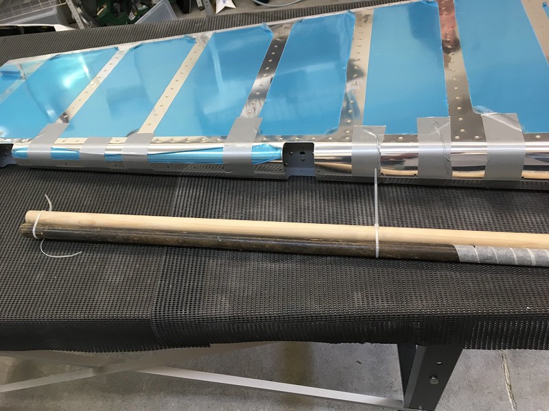

Alternative Method
Hi Guys

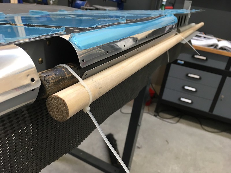

I thought I use this thread to also share my method. It's low tech but works quite well. Especially for the bend of the RV14 rudder according the required bend profile as described in the manual. The thing is, that of bend the skin at the first part more than where the two skins overlap after the bend. The overlapping part is almost straight. I heard from a friend that he had to massage the bend a little after he first attached the rudder to the VS because the rudder leading edge was not bent "flat" enough.
So take a broomstick and a similar piece of round wood, cut it to length if necessary and simply hold them together with cable tie. It is easiest to bend it if you are two guys, one on each side...

I am sorry, I constantly forget to measure when I am at the workshop. It?s around 1 1/4 inch. But I really just took the broomstick that was lying around. The diameter is not really crucial, just make sure it is less than in the templates...

One more hint: after rolling the skin with the ratchet all the way to the spar, the bend wasn't good enough to have the halfs overlap easily. What I did then was to put the rudder on its trailing edge and use just my hands to tightly roll and squeeze the skin around the rod by pressing hard with my fingers on the edge while bracing the skin with my hand to not put any pressure on the skin near the rivet end. After that the skin had assumed the rods shape all the way to the edge and with just a lite push, the clecos went in.
