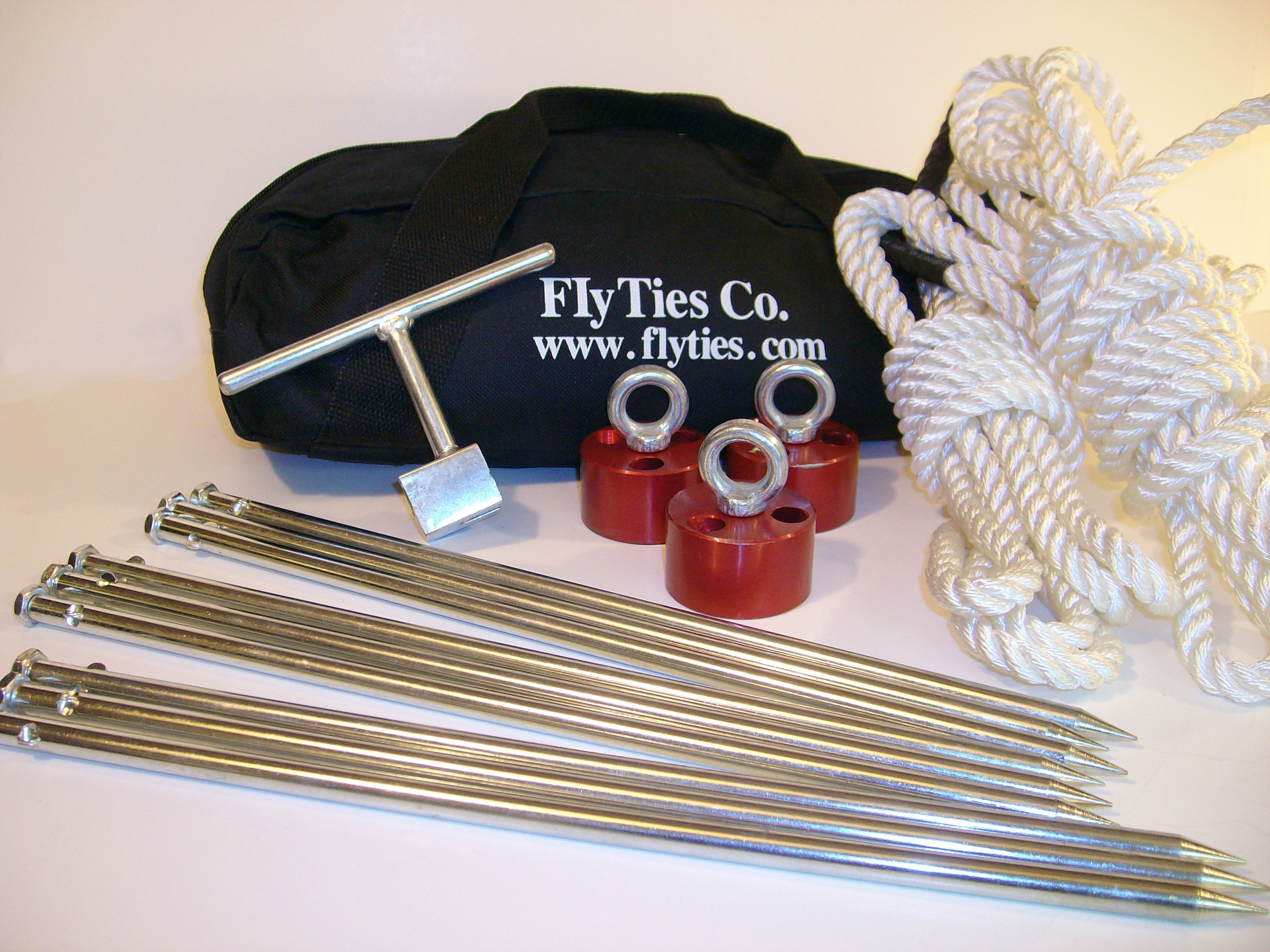

EAA (Experimental Aircraft Association)tie-downs use stakes and have performed well in tests, holding only 400 pounds before failure in one case.
The claw failed at 650 pounds of force in suitable soil,
Any of the systems that use a straight peg need to have a longer rod, driven into the ground and need to pull at an angle to be effective.
Aviation Consumer test found that a spiral "doggy" auger resisted 575 pounds of load Before the head deformed! so take away the 2 possible failure points for the Pekinese tie down and its actually a viable solution.

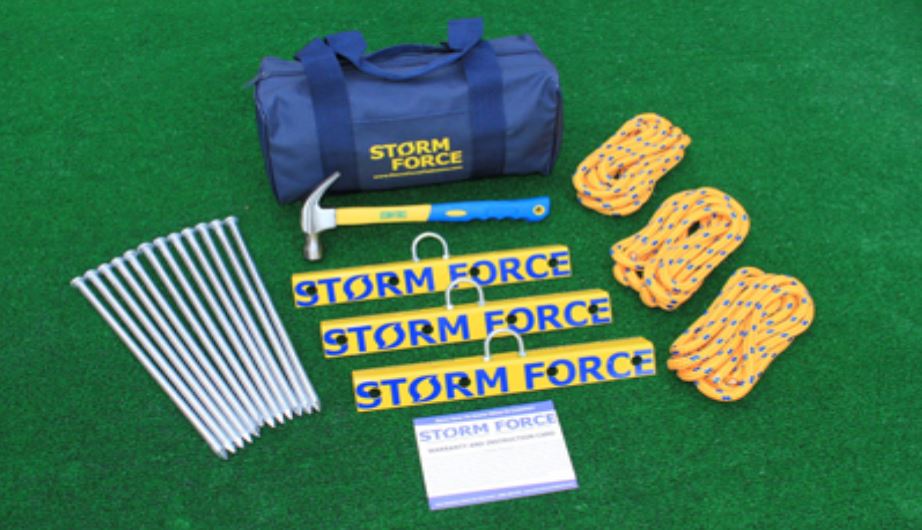

I made a set of StormForce lookalikes for beating back the masses.

We have always had great success (at Oshkosh) with the EAA Homebuilder tiedowns, which uses a surface plate and three stakes driven through it at angles. It works really well in the Oshkosh soil - have never been able to use it in the rocky soils/dirt/rock out west. The lesson being that different regions have different requirements - what works at SnF might not work in Oshkosh…and vice versa.
I’m modifying one of our sets of EAA Tiedowns with Titanium stakes right now. Why? Because I got a good ear on three 3’ lengths of 1/4” titanium on E-Bay, that’s why. Cut them into manageable lengths of course. Took me DAYS to cut threads on the end of each one for nuts. They’ll be trick, and won’t bend like my steel takes that have been pretty abused over the years.
My annual reminder on spiral dog-stakes. Absolutely do NOT use them to tie down next to me if you bought them from any big box, pet, or sporting goods store - the triangle at the top will pull right out. But…. Years ago, a fellow sold sets of them made from Titanium, and they are heck-for-stout … and don’t weigh much. There are still a number of them in use, one set that we carry in our RV-3. So before you go medieval on someone for using what looks like a dog stake, you might complement them on having one of the few sets of titanium ones, and if they accept the compliment and tell you how great they are, you’re good…and if they give you a funny look, then you know they bought steel ones at Walmart. Move your plane somewhere else…..
I have a set of EAA tiedowns that I made years ago, using 18" titanium rods as Ironflight did. Had just as much fun threading the ti. I've never put them to a severe test and I won't weigh with a "mine's best" opinion. But I have had an experience that some may find interesting.
