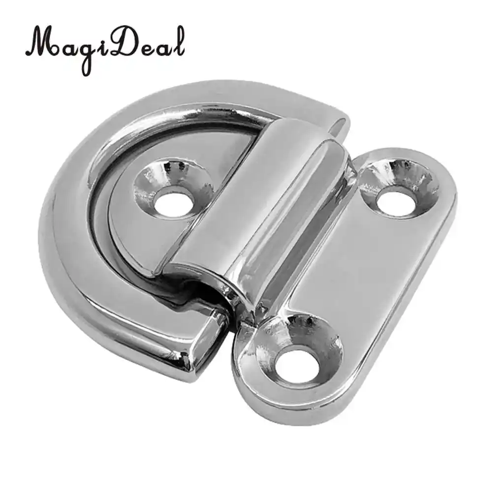

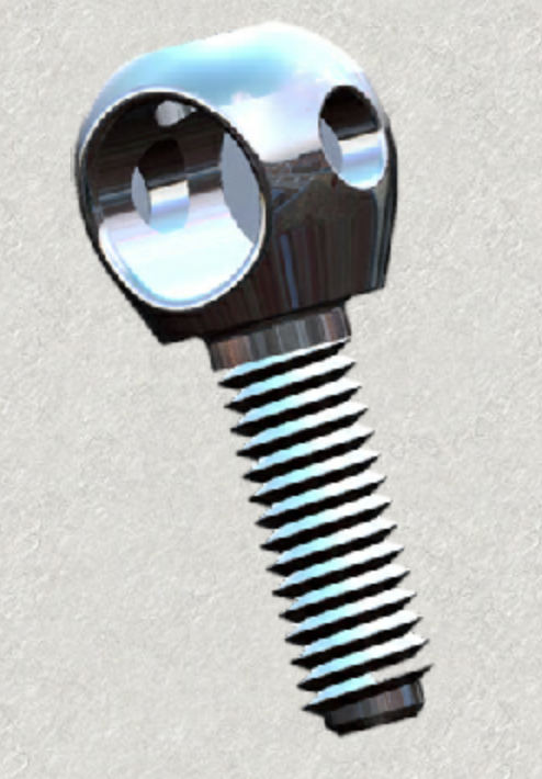

Folding tie down rings
Can someone please make folding tie downs for our RVs? An aerodynamic blister or fairing shape with a center bolt and a fold down ring. Google folding tie downs or folding race hooks and there are lots of ideas. The ones below are just rough ideas.
