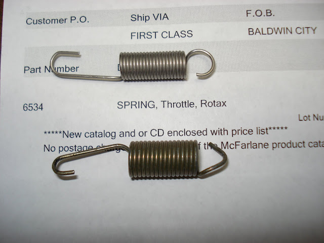

Update on the new spring from McFarlane
I installed and test flew the new springs this afternoon. Before I swapped springs I measured the amount of pull required to move the throttle out, using my highly calibrated fish scale. ;) Approximately 6 pounds of pull required. Then I swapped out the springs and re-measured: between 3 and 4 pounds.
Then taxied and flew. Big difference. I can now actually set the friction free enough to allow power changes without backing off the friction every time and retightening it. Still takes a bit of finesse to find exactly the right setting. On final at idle the power did not creep back on as it had before.
The new springs definitely have enough strength to achieve the desired fail-safe operation. They appear to be of good quality, although the wire is visibly a smaller gauge.

Thanks for posting your mod.
removing ~50% of the spring force is a lot (my 2c only, YMMV).
one more measurement people can take:
after removing the old spring and before installing your new spring,
pull your throttle to idle, tighten the throttle as much as you can,
then take a measurement from the engine side to see how much force is required to move it.
(ie. how much force is needed to create the throttle creep).
It would be interesting to see different airplanes' measurements.

Here is a picture comparing the original Rotax spring with the replacement from McFarlane. At least I think you might be able to see it if you follow the link. I just spent a couple frustrating hours trying to make it show up in this post. I don't know why that has to be so hard to do, at least for me.
Having flown with the stock springs for 35 hours, removing 50% of the tension is not a negative. I have 2 choices. Live with creep, or crank it down to where throttle movements are a chore. I have been amused with all the comments about "if the cable breaks, you will crash" Yeah, maybe.
The cable is a very simple mechanical contrivance. It is a knob, a cable, and a sleeve. Using my standard vision, I can inspect it with ease. If it is rusted, or frayed, I have a problem. Are the nuts tight? If all of the above are negative, what is the big problem? I've driven for 43 years. I've never had a cable break. Half of this time was with old MG's. Everything breaks on MG's, except the cables. I don't know anyone who has had a throttle problem, be it in a car or a plane.

Replacement of these springs is Vans responsibility. Hide as they may behind a wall of official silence, third hand reports of collaboration between Vans and Mcfarlanes is credible. To keep faith with their customers, I think Vans needs to announce a free replacement program. This is a safety issue, despite their deafening silence.
I am trying to fix the problem for my aircraft by getting springs from Tom. But I would rather have the McFarlane springs. And I dont see why I should have to buy them.
Rod
RV12Photos

I flew Sweetie for 25 hours. Then swapped to the springs obtained by todenhal. A GREAT improvement! The functionality is the same without the annoyance factor. Recommended!
I think I was the second
or third person to buy/install the new McFarlane springs. Functionally. they're about the same as the ones I bought from a forum member; however the bends are much smoother than those I made (less likely to break) and the arms are longer making them easier to install. I'm approaching 50 hours on them. Do I like them? I have a second set so if one does break I won't have to go back to the originals! In the big picture of RV-12 costs, the cost of these springs is miniscule and the airplane is a lot more fun to fly without worrying about sudden power surges. Yes, if the throttle is unlocked, they'll open it wide-- but slowly. not instantaneously.
Wayne 120241/143WM
Flying happily with the McFarlane springs....
....... since November 2011. No problems. I would never go back!
Best Spring I have Found
Guys, Joe Gores at [email protected] sent me several Century Springs that he had modified from PN 5553 and worked great on two airplanes that I have used them on. The minimum buy on those springs caused him to order a bunch, and I am sure he has some left over at a very good price if anyone is interested.
With the new spring there is no throttle movement with friction off and engine not running. With the vibration from a running engine the throttle slowly opens to full, but with just a little friction it remains in place. What a difference it makes. Jim
