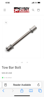

I love the JD Tailwheel but I bought the flyboys double arm with the tiedown hole and their extended bolt for the towbar.. I can’t find where they sell the two hole arm separately, but they used to.
Blake still has the double sided control arm with tiedown but they are presently sold out. I have one on my RV-6 and one on the shelf for my RV-8 project.
