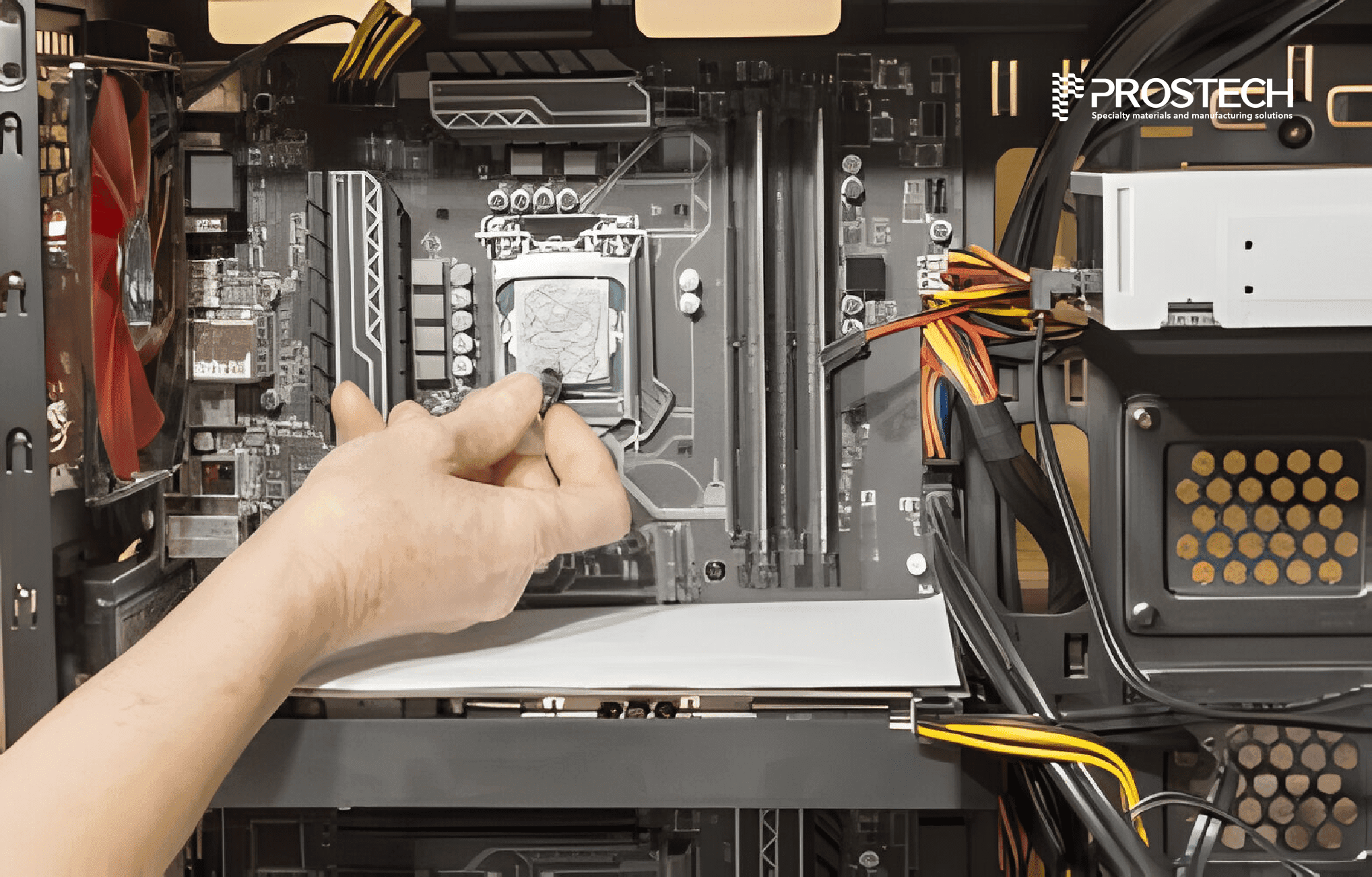

Cons of silicone-based thermal interface materials
  • Outgassing: This phenomenon is the release of volatile gases when silicone based TIMs are exposed to elevated temperatures and/or low atmospheric pressures. This can be a concern in sensitive electronics applications, optical components, particularly aerospace applications where outgassing is accelerated due to reduced pressures and may also cause problems within sealed cavity packages.
