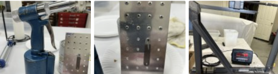

AD-41H rivet installation
…HFS reply
I recently "tested" some AD41H rivets I got from Spruce just for this purpose. Don't know if they are from the same production run as those you had trouble with, but with my thrifty (read - cheap) HF pneumatic puller, operating at 90 psi, with a speed reduction mod to help slow down the "snapping" action associated with these types of tools, I had acceptable results. Also used an "insulator" tool with a .068 hole to help reduce the possible of "feathering" of the soft aluminum head during the pulling process.
I also did a couple of overlap shear tests, using Pop's stated spec for this rivet as 385 lb ultimate shear. Neither test produced results that confirmed those specifications. Two samples: 2 x .032 w/2 AD41H rivets on 1" c-c yielded 540 lb & 530 lb at failure. By Pop's specs, should have been, at least, 385 x 2 = 770 lb. Not even close. My testing device is not an ASTM certified unit, but is does a good job for relative comparisons. It uses a 3K lb load cell with a digital readout - load application rate is ~ .1"/min.
