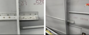

RE Grounding a Z-14 dual battery configuration in an RV-10
…FMF15E
I used the longeron. The F-1013-R runs from the baggage compartment to the firewall. I fabricated a 1x .125 angle that provided a secure mount for both ground lugs in the aft section of the fuse, this was riveted to the aft end of the longeron.. Then I used the hole in forward section of the longeron that was intended for the forward install of the rudder pedal mounts to attach a cable that connects to my forest of grounds and the firewall and the grounding braid to the engine.
This is like what LR172 posted above, but I wanted to ensure I had a robust mount for the ground cables that would provide a rigid fix. You can see the two holes for each of the two grounds coming off the dual earthX batteries I plan to use.
