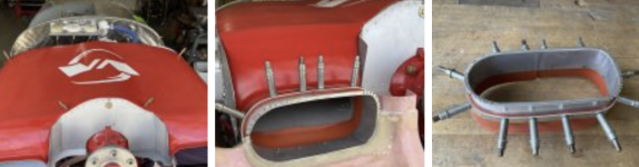

Webb’s Plenum PIREP
I took a slightly different approach. I made rings the shape of the opening and used baffle seal on the rear of the ring so the ring acts as an extension of the cowl and the seal lays on top of the ramp and under the plenum similar to the vans designed use of baffle seal. I elected to go this route instead of a neoprene tube connected to the plenum.
After the bottom cowl is on, the ring is slipped in place, and the plenum is placed on top of the ring. Then the top cowl is placed.

Webb’s Plenum PIREP
