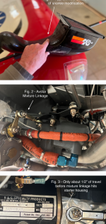

My RV-8 (Lycoming IO-360-M1B) has gone through two Sky-Tec 149-12LS starters and now the 3rd is starting to act up. I've heard only good things about B&C, so I purchased one of their starters (BCS206-149-12) only to find there are some fitting problems: First, it runs into the snorkel (Fig. 1)...

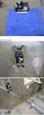

I had some additional "hat" section of material from the canopy release system and used that to create a place to mount the brake valve. Nutplates on the back of the hat section hold the bolts that go through the brake valve body. A piece of aluminum sheet with a "V" cut out allows the arm to move from open to closed on the brake valve.

Has anyone added a switch on the Matco parking brake valve to indicate valve position?

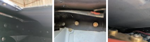

If you mean for maintenance access, yes. This is mine (also on my flying 8 and very handy.

Has anyone added an access panel on the left side of the forward baggage area?
