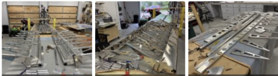

I did just what others suggested. I am building the two ailerons across from each other as mirror images. That really helps in orientation. I clecoed everything together this afternoon, including the leading edge and aft skins. I then disassembled, completed all of the countersinking, finished scruffing surfaces and I am ready to prime mating surfaces. I think the actual riveting will go pretty quickly. I did the same mirror image assembly for the flaps, visible in the background.

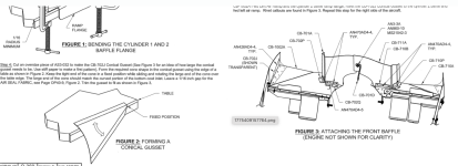

Before I just keep making attempts, any advice or tricks you found helpful in making the corner conical gusset for the baffles (outside corner of inlet)? I have a good paper shape, but so far my attempts at turning that into aluminum have been pretty sub par. Bending/rolling became easier once...
Ailerons Build
Does anyone have pictures of the right and left ailerons being built? I know that a few have had to backtrack because of the spar orientation. Just wanting to avoid building it upside down. The plans only show the left aileron, so I’m sure the right is a mirror image of the left, but pictures help.
