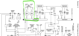

According to the electrical schematics in the POH (and the Rotax Installation Manual) the Fuel Pump Switches only switch the ground side of the Fuel Pump circuits. There is no "fuel pump power" going through the HIC connectors from the ECU or to the FP Switches.

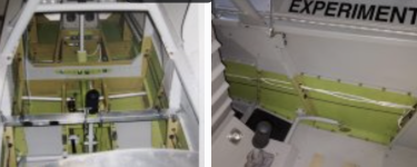

I went out and took a photo, the issue is you can't get CS-00002 through the bulkhead hole and the F-1489A because F-1489A is too tall, without it, CS-00002 just fits sliding in from the aft. It doesn't fit trying to slide from the front into the aft.
And you can imagine if the bell crank was installed, it just makes things worse, as it's totally in the way to slide in from the aft.
Hopefully this clears things up.

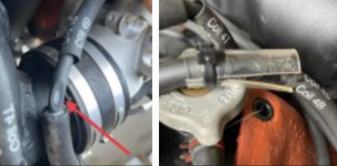

12iS Spark-Plug Wire Chafing
When performing my 5-year coolant hose replacement, I had to unbolt the ignition coils to gain access. When I folded them back, I discovered the #4 cylinder top spark-plug wire had been rubbing on the air box and worn through the outer jacket and into the core. This was at 450 hrs. Five of...

I'm looking at section 36, 56, and 58 to do the servo bracket installs while I have the tailcone free before the big join. When I rivet the yaw servo mount (F-14189A/B) to each other and F-01407-L/R, will I be able to remove the bellcrank plate (F-14139)? I'm wondering if others can let me...

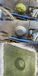

The plug I formed up doing a layup on top of the cowl. Then made some edges out of foam sandwich. Set that at about 1/2 under the inside of the cowl.
Spent a bit of time making the oil filler recess.
Once it was all done I 2k the plug and polished up.
The mold was just polyester. Cheap and quick.
I did go down the rabbit hole on post curing and high temp resins but it was the middle of Covid and it all got too hard. I thought about making an oven too. I ended up talking to a well respected composite builder locally that convinced me to do the layup in vinylester. I got one locally that has a Tg of 135c so 275F.
Miraculously I pulled that part on the first attempt. It was also my first ever infusion. So beginners luck I guess!
After that sucess I made a set of engine mount bolt covers for the rear baffle. That was trivial by comparison.

Hello hive mind, I am reworking my plenum cover and looking for material that's stiff enough to resist bowing/bending from the incoming air, yet flexible enough to span 4 cylinder heads and absorb their movement relative to each other. Pictures of the current plenum cover below. I used...

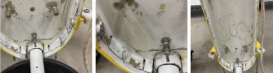

I have sent these photos with a brief email to Van's and awaiting on reply but I'd like to get thoughts from brain trust here. We found cracks in aft bulkhead on 1995 RV6 with 1700 hours. The bulkhead appears to be two identical bulkheads sandwiched back to back. Thoughts on proper procedure?
