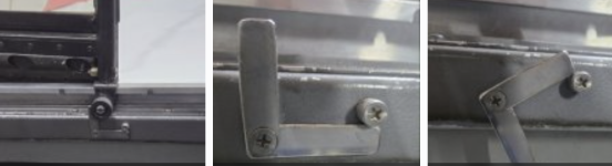

RE: Slider canopy stop / latch
…MikeyDale PIREP
I solved this problem about 5 years ago and it has worked great! I have the Flyboys Supertracks Canopy extension so I have a roller as you can see in the picture. You could come up with a piece to replace it if you dont have the Canopy Extension. I made a L shaped piece from a piece of stainless steel sheet I had laying around. I attached it in the middle with a stainless screw and nylock nut with a deldrin washer between so that it will rock with the smallest of effort yet stay in the position I want. Then I put another screw with washers to act as a stop. Now I can move this small inconspicuous piece with my elbow while taxiing without even looking. Pictured is the open position and the closed position. Closed position holds my canopy open about 6 inches open.
…MikeyDale PIREP
I see flyboys do one for the 8 which looks a nice solution but doesn't work on side by side RVs Any neat ideas on a latch/ stop that allows you to have the canopy open a few inches for taxying ? RV 9 slider.
