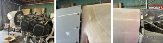

Cowl perimeter edge extension - how much is too much?
Fitting my cowl this weekend. I Purchased the old pepto bismol pink cowl a few years ago from a guy that went horizontal induction rather than vertical. Since I already have my ground adjustable fixed pitch sensenich prop and spinner, and to set the 1/4" gap, I bolted on the starter ring and...
