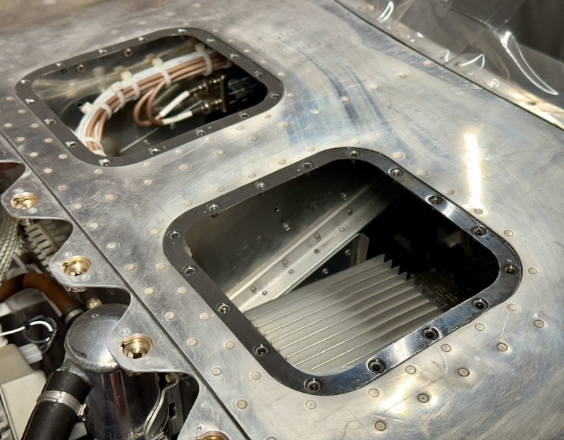

Well I cut my access panel cutouts today. It definitely took some time getting the gap the way I wanted it but I think it looks pretty good now. Dimpling was done after fitting BTW.
Dan, I can't really tell from your pic what happens in the area around the screw holes. Is there actually any gasket in that area?
Eric, I'm curious why you decided to make the screw holes so large. With the holes that size it seems you aren't sealing around the screw. Did you try making the holes smaller?
I think I'm going to give Dan's approach a shot. I'll get to buy another chemical I haven't tried before that way.
I did start with the holes smaller but I enlarged them so the dimples would fit better. You can always modify the Fusion 360 file to make the holes smaller if that fits your need better.
Once the seal is cured, do we paint right over the Proseal that fills the gap or does it need to be removed first. I would thing the paint would chip at the edges whereas if we paint on the soft Proseal. Thanks and Happy Holidays, Ron
I followed Dan's technique and my access panel seals turned out really nice:
More pictures here: https://www.rv7blog.com/2024/02/27/access-panel-seals/
