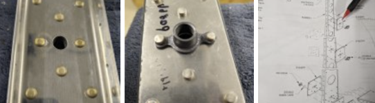

Did I just ruin my Rudder Spar with smiles?
Sigh... I was squeezing the rivets that attach the K1000-6 nutplates to the Rudder Spar (R-00902-1) on Page 07-05 and must have been getting tired... I now have two smiles in the aluminium.
Have I just ruined it, What do the experts think, will I need to buy another spar? (I'm kicking myself
Sigh... I was squeezing the rivets that attach the K1000-6 nutplates to the Rudder Spar (R-00902-1) on Page 07-05 and must have been getting tired... I now have two smiles in the aluminium. Have I just ruined it, What do the experts think, will I need to buy another spar? (I'm kicking myself :()
