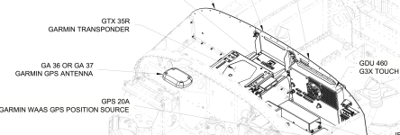

My RV-12iS has the dual G3X VFR package that has had the GPS20A removed and replaced with the GPS175 in March 2023. Last fall, shortly after a take off in VFR conditions, the G3X map screen and PFD background displayed in the color red and the audio alert of "terrain, terrain, pull up, pull up" began repeating itself. Having flown from that airport multiple times and also being able to see clearly on a CAVU day I knew there was nothing in my path at my altitude and continued my flight. Once at cruising altitude my pilot/passenger and I began to assess why this may have occurred and came up with a WAG (wild assumption guess). We were attending a fly-in event that had many aircraft departing once festivities were over. I had just started up and the GPS175 was still in TERR TEST mode when the marshaller began directing me to pull into the line of traffic moving toward the runway. My temperatures were in the green so I began movement. We both figured that moving the airplane while the TERR TEST was still being conducted confused the navigator as to actual location so I made mental note to always wait for the test to complete before beginning to taxi.
Waiting for TERR TEST to complete before movement seemed to do the trick for quite a few months. Then in March of this year I was departing another familiar airport on a VFR day when the same "terrain, terrain, pull up, pull up" event again occurred despite waiting. I wrote it off as a one time thing before it once again occurred leaving an unfamiliar airport (but in a very flat farmland area on the Illinois/Indiana state line) in the path of totality for the April 8 eclipse. Because this was once again taking off from an event when everyone else was I wondered if the close proximity to other navigators could have an input to the problem; after all, two of the three data points are leaving crowded events. However it happened again just last weekend at a small uncrowded airport.
Fortunately all these occurrences were in VFR conditions. Until I figure it out I will not be taking off into IFR conditions. Has anyone else experienced this navigator behavior? I'm stumped on where to begin my research.
Your alert audio will be coming from one of your GDU displays, not your IFR navigator.

It is the standard -12iS dual Garmin G3X VFR package. This includes a Garmin puck antenna (coupled to the PFD) that is mounted under the aluminum sheet that covers the avionics bay plus the GA36 antenna coupled to the GPS20A that is mounted firewall forward under the cowling.
After airworthiness the GPS20A was removed and a GPS175 installed using the existing GA36 antenna. A little over a year ago I began getting terrain alerts even when 2,000' above the highest terrain. I also showed up as traffic to myself with a yellow "00" on top of my own icon on the G3X traffic page. I ended up going to an avionics A&P who reran a ground line between the GPS175 and the GMU11. That didn't make sense to me but I did get almost a year of flying without the erroneous terrain alerts occurring. Now the erroneous terrain alerts have returned so I am revisiting this thread. Same thing as before with the yellow "00" atop my icon on the G3X traffic page plus the "terrain, terrain, pull up, pull up" audio and terrain depicted in red on G3X screens. Yesterday it continued the entire 5,500' of climb plus a few minutes of level flight.
My guess is this is the result of the puck antenna attached to the G3X being mounted under the aluminum. If there isn't a method for having the GA36 antenna be the antenna in use for terrain then next month during my Condition Inspection I plan to move the puck antenna from the avionics bay out to be under the cowling.
The GPS antenna is inside the metal fuselage? This doesn't sound like it comes close to meeting the GPS antenna mounting requirements from the G3X installation manual, which state in part:
The GPS antenna is a key element in the overall system performance and integrity for a GPS navigation system. The mounting location, geometry, and surroundings of the antenna can affect the system performance and/or availability.
Mount the antenna on top of the aircraft in a location with an unobstructed view of the sky.
The GPS antenna should be mounted in a location to minimize the effects of airframe shadowing during typical maneuvers.
I know some have had success with antennas mounted in the hot engine compartment, but I don't like it, and the installation guidelines don't either:
Due to the excessive temperature environment and large areas of signal blockage caused by the fuselage, mounting the antenna under the engine cowling (forward of the firewall) is not recommended and likely will not provide adequate GPS reception.
My KAI's indicate the the GA36 is located FWF under the fiberglass and the supplemental for the Nav/Com should be a GA26 affixed to the same bracket F00196-1, See 42Pis-22. There shouldn't be any GPS puck in the avionics bay.
I agree wholeheartedly which is why my plan is to move it forward of the firewall to be side by side with the GA36. Why Van's has it mounted in the avionics compartment above the center stack is surprising.

It can be a little complicated, to be sure. Section 2.1.1.8 in the current installation manual (revision AV) spells out the requirements:
GPS data is used for ADAHRS performance monitoring, so at least one source of GPS data is required. This requirement can be met by installing a GPS 20A, or by connecting a GPS antenna to at least one GDU GPS receiver. A GTX Series Transponder with built-in GPS, or a GNX 375 connected to the system will also satisfy this requirement. In a system with multiple GDU displays, additional GPS antennas may be connected to the other displays for redundancy, if desired.
The G3X system is capable of displaying basic position data from an external IFR GPS navigator, but this data is not used for ADAHRS monitoring and thus does not satisfy the above requirement.
So if your installation has a GPS 175, that box will need its own GPS antenna, since every IFR GPS navigator requires its own GPS antenna. Then for your G3X system you'll need at least one of the above GPS sources to have a correct installation, since the GPS 175 doesn't count towards this requirement.
In the OP's case, the original installation started with a GPS 20A, which was all that was needed. Then the GPS 20A was swapped out for an IFR GPS navigator, which doesn't satisfy the G3X system requirements for GPS data. A second GPS antenna connected to a GDU was added, which is one of the correct ways to remedy this issue. But, it sounds like it was installed inside a Faraday cage, which no antenna is going to be happy about!
Nothing added. This was part of the original package. Being beyond the airworthiness certificate I will be making the change next month to move it out of the avionics bay.

Here is what should have been the "original package"...
This is how Van's does the second antenna.
