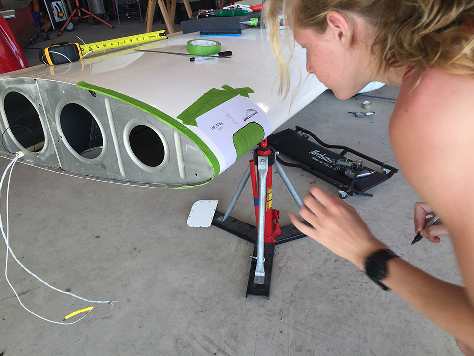

First Step was to mark the correct location

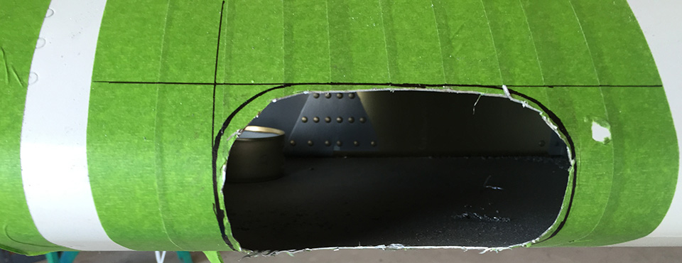

Second was to cut out the hole. Per the instructions I cut a rough hole then snuck up to the line.

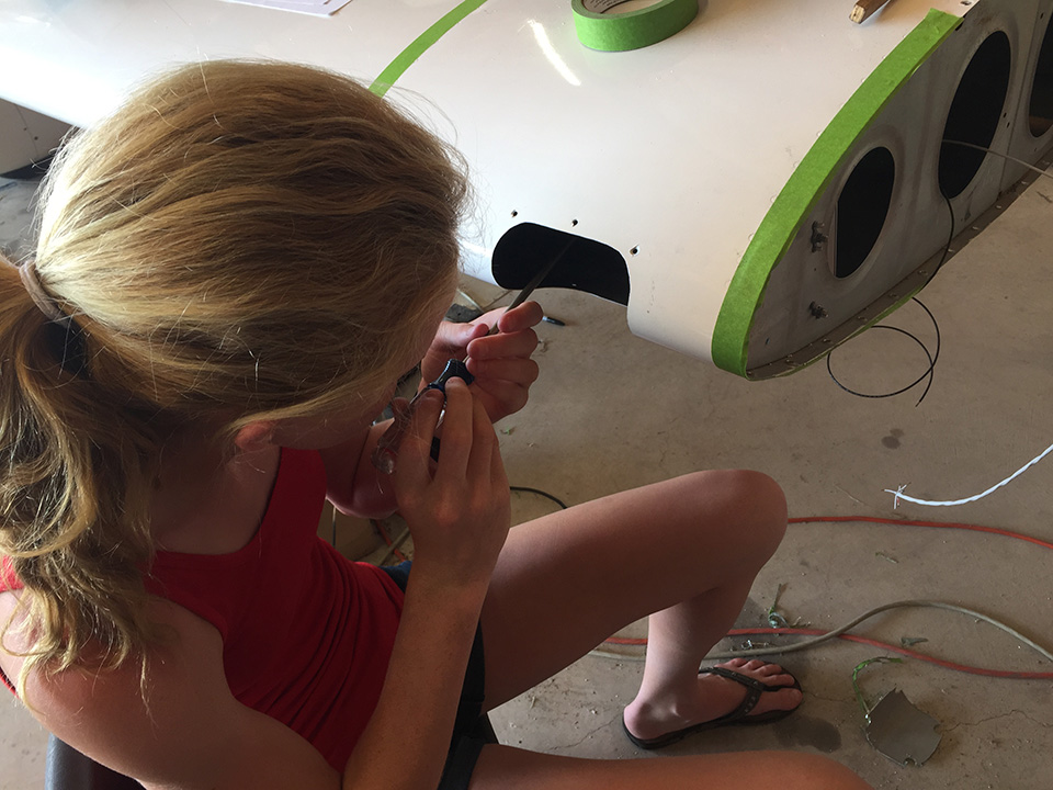

My daughter built the assemblies and installed them (Not only did she learn how to rivet, but she also go to learn how to de-rivet!)

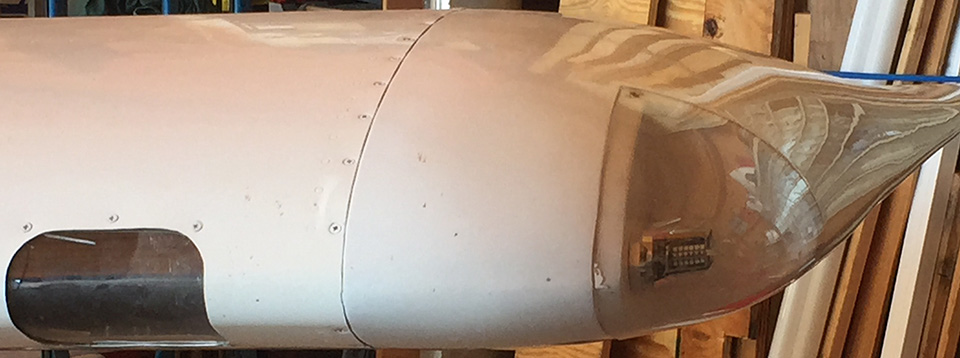

We built the cover assembly and attached. I made a mistake on this one as it cracked after several hours of flying. The other one is still perfect so obviously I didn't relief sand the plexi correctly. Practice makes perfect! You can also see in this pic the position/strobe light. It is very bright and all three sync perfectly.
