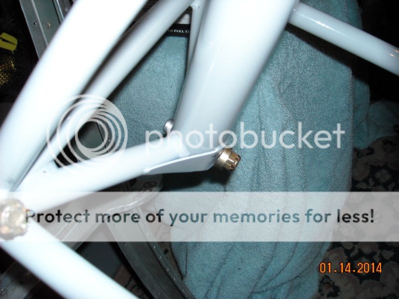

First. I made sure the motor mount was secured to the work table. I used adel clamps and screwed it to the work bench:
NOTE Towels and plastic. I used LOTS of oil!
