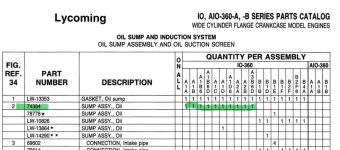

I have a sump which came with my core engine (for overhaul). The engine is a C1E6 which had rear facing injection, but it came with a cold air forward facing lycoming? sump.
The part number on it (I think!) is just the casting number LW-13783, but this is not a part number I can find another in the io360 a, b IPC, or in the io360 C IPC.
It certainly looks like a sump in the IPC image, but I can’t definitively tie it to a part number. They don’t label which sump images are which part numbers! They are all labelled (2). The most common seems to be 74384 and a Google of that shows sumps which look like mine.
Anyone know how I go about properly identifying this sump other than “it looks like the one on google”?

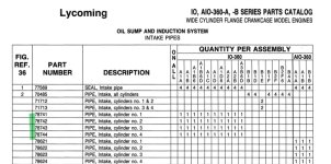

I’m also trying to identify the intake tubes - they certainly look like a set from an A Series engine, but again, no part numbers identifiable.
And for some reason there’s a hole (and a dent) in the #2 pipe.

Can you provide photos of the front and rear of the sump? That is definitely a Lycoming angle valve sump. Send me a direct message with your email address. I will email you photos of my IO-360-A1A sump and intake tubes. My tubes look different than yours.

That hole looks like it was drilled to accept an EGT probe

The sump will fit. the same forward facing sump is used on both the 200 hp version and the 180hp version. The intake tubes are however different between the two installations. The pipes in the picture I think are form a 200hp engine by the looks and memory but not 100% sure. The hole in the one pipe was for a stand by vacuum system pickup.

Closure:
Heard back from our local lycoming rep:
“I have checked the drawings this morning and can provide the information below.
74384 was superseded by part#: LW-13864
Looking at the drawing for the LW-13864 it lists casting LW-13783.
Based on that information we can assume that the sump assembly you have is either Part#: 74384 or LW-13864”
I looked into these 2 part numbers - LW-13864 seems to be only installed on the AEIO series of engines. The original engine shop where this sump came from mentioned “it is probably one of the old partenavia sumps we had”. Basing on this, the IPC says the 74384 gets fitted to an -A1B6 (partenavia). So I would say this is the PN for this sump. Certainly looks like the eBay pictures when i google that number 🤣
This would make the tubes #1 74781, #2 74782, #3 74783 & #4 78744
