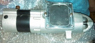

I wish Id bought another one of these when I got it, you just cant kill it. Got it NOS sat on a shelf for 8 years and finally wound up in ebay where I picked it up for 325 bucks back about 5 years ago. Kelly was bought by Hartzell and CANNOT believe how much starters have gone up in the past 5 years, these were around $600. new at spruce a few years ago

Wow, it seems like Kelly aerospace was yet another company that made a more reliable starter. Welp, lucky you! Maybe one day Skytec will fix their solenoid issues.
