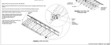

I think I am going to have to replace my stall warning switch. I can’t get continuity between the two wires with the switch activated. Does anyone know what the voltage on the terminal wire is? I am only getting 10.6 volts? I am thinking it will be easier to take the wing off so that my old arms and hands can work in a more comfortable position up in the little access door. Any ideas appreciated.

The voltage on the sense wire to the stall warner switch from the module is not published as far as I know, but 10.6 volts doesn't seem bad. Vans support may know that technical detail specification.
There should be continuity between the switch "common" and "normally open" terminals when the vane is activated up.
The idea to take off the wing and place it upside down on some padded saw horses will make it easier to reach.
It will also help to have a large dental type inspection mirror and a LED work light to put inside.

On a plan's built E-LSA RV-12 with Dynon avionics the stall switch in the wing is wired normally open and when the vane is activated UP it closes the switch and grounds the sense wire.

Can you hear the switch click as the vane is moved up and down.
If not, the bracket might need to be adjusted. Two screws hold it to a rib.
The top screw hole is slotted. The bottom hole is round.
Loosen both screws one half turn to adjust the mounting bracket.
