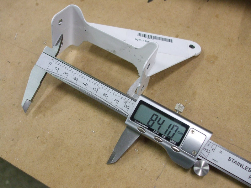

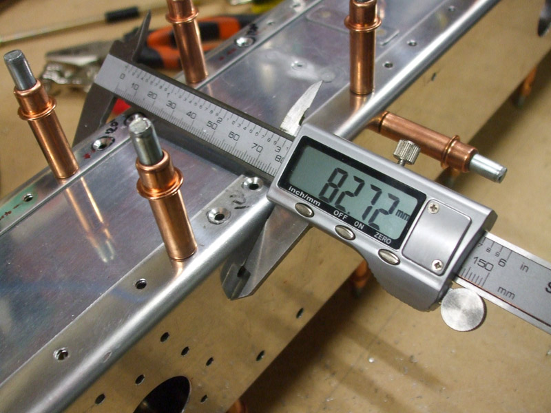

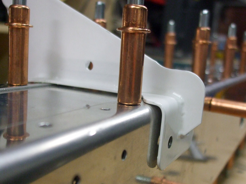

I've put together the spar box assembly and tried on the control horns. (Page 09-03). They turned out to be about 1.5mm larger than the spar box. (see the attached pics). There must be some spacer or a doubler between the horns and the spar, but there is nothing in the plans.
What did I do wrong? How do I fix it?
