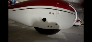

For some time, I’ve had the 1” hole with the flush plastic plug on my various RV’s. That seemed fine except that prying that plug out of there started become a pain. So, I just tossed the plug in the trash, leaving a 1” smooth open hole, and I also have the paint line on the tire to located the tire valve. So look at the pic below. Do you really think that open hole is going to slow you down? What about that great big hole on the bottom with a tire sticking through it?
I don’t think it makes me slower, in fact, I think it might make me a little faster - here’s why: as you’re “flying along in flight” that opening in the bottom of your wheel pant is ‘scooping’ a certain amount of air. That air has no where to go. There is a certain amount of back pressure builds up looking for a place to escape(drag). My little hole relieves a little of that back pressure build up/drag - ergo - I’m a little faster now. Why do I think that way you ask? Allow me to “splain”……. Several years ago, a friend of mine from Louisiana had Radial Rocket (taildragger). It had wheel pants like ours. They were bigger, but pressure recovery ones shaped just like ours. He installed NACA vents in the aft end of the wheel pants, backward so they were sucking instead of blowing. He “claims” he picked up 5 knots with this mod. In the end though, do I really need to be any faster? I say no. I only need to be faster than all my RV formation buddies - and I am!!
