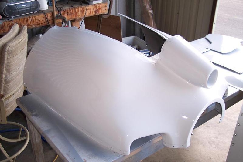

Cod Piece
I have no idea what a "Show Planes Cowl" looks like but, on my Lancair, I made the bottom of the lower cowl removable so I could change the oil, check the carburetor linkages, and gain access to the air filter without removing the top and bottom cowling halves. This is the bottom cowling half with the "cod piece" removed:
