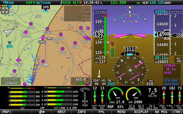

Just ~1 hour to go for the 40 hour test period. Yesterday was the high altitude data run (up to 17.5K?). As part of this run I wanted some raw data to develop cross country cruise setting. At first blush it looks like ~14.5K? is where, for the same speed, efficiency starts to fall off.
For these typical high speed cruise settings I got 27.3MPG at 14.5K?, then slowly dropping off to 26.5MPG at 17.5K?.
I?m sure I could enhance the MPG numbers at slower speeds, but shoot fire, we fly RVs!
14.5K? screen shot attached.

![68392008-B0-A2-4-A1-A-9-DD7-6-F02329-A82-AC.png](/proxy.php?image=https%3A%2F%2Fi.postimg.cc%2FvBkZFMKv%2F68392008-B0-A2-4-A1-A-9-DD7-6-F02329-A82-AC.png&hash=215a45eb81000fe94921b3fa2ebf589c)
