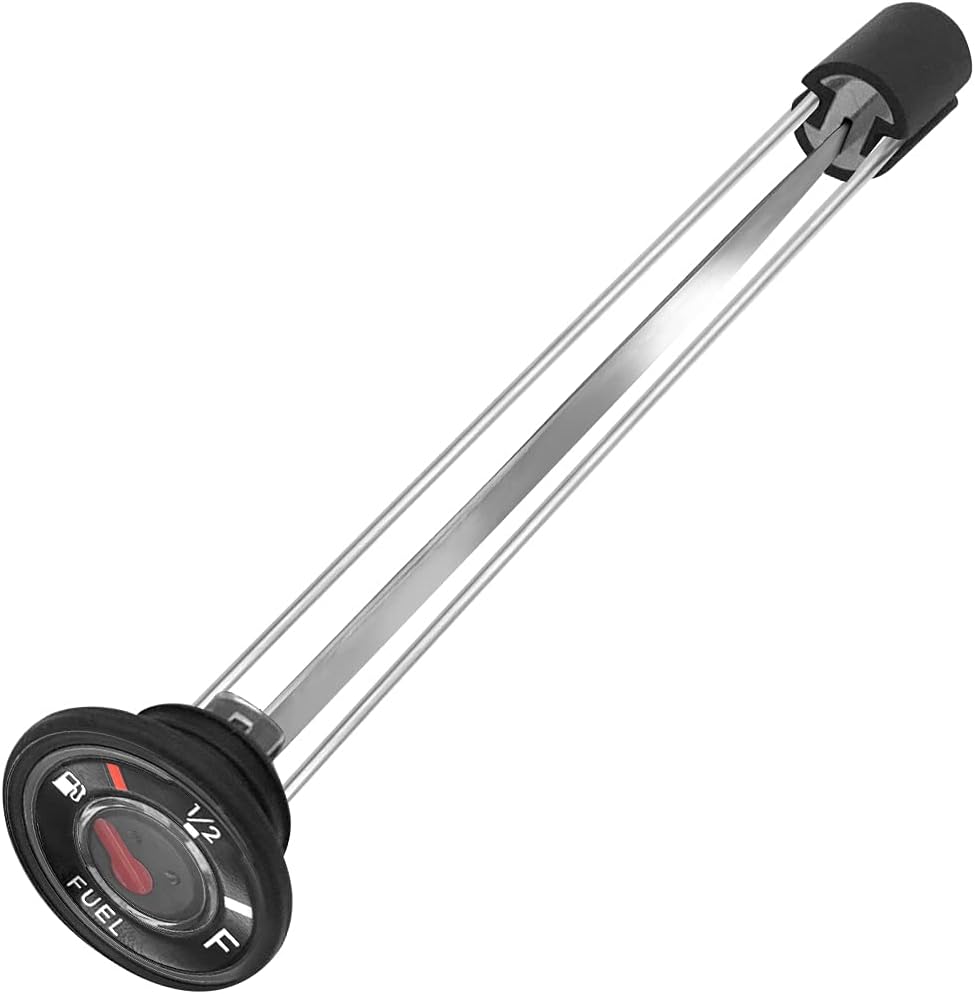

That’s a pretty good idea since you could mark the gauge at the correct fill level the first time you fill it and not have to guess looking down into the tank. If you had a picture and a link for the gauge that would help. This forum is worth every penny!
What I got is something like this:
I don't have a link for the exact one though. I just cut a hole in the top of the tank, carefully cleaned all the swarf, and prosealed it in. I can try to get an installed pic next time I'm out in the shop.

Perhaps more reliable than a mechanical gauge, and slightly more complicated than having a see-thru tank: A pair of 90º elbow fittings and a length of plastic tubing gives me a sight gauge.
(not my idea, but I'm glad it's there)

Here is a simple, cheap, effective solution to the problem of over filling smoke oil tanks. Make a dipstick for the tank just like your engine oil dipstick, use it and you will see exactly how much smoke oil you need to put in. Remember that most tanks have a FLAT TOP, that means that they SUDDENLY get full so be a little bit conservative on how much to add.
