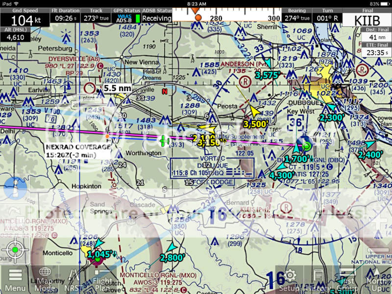

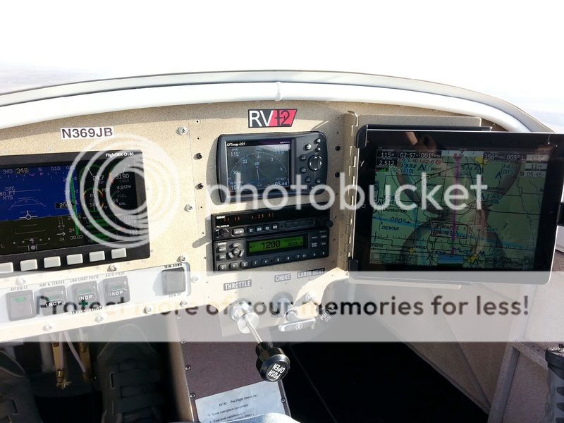

This is a screenshot of a Flyin and my dash layout. VERY happy with this setup.
I was wondering what the presentation looked like with an iFly system. Now I am sold on using the Navworx ADS-B. Thanks for the screen shot!

My entire reasoning is the 496 screen is so small, it is near impossible to see much meaningful on it. I did not even wire the input to the GPS from Navworx. The 10" IPad Pro with non-glare screen is so much better as the screenshot proves, I only look at the 496 GPS for a basic track and some basic info. The moving map from IFly works very well and I like the translucent 'buttons' on the bottom. I like it better than some of the other apps for that reason. If you touch one of them, they darken a little more, then go very light after that again. You get to see a bigger picture. If you look at the ADS-B 1/3 screen on the Skyview, and had an IPad beside it, you would drop the ADS-B off the Skyview if you had the option.
I am in no way knocking the SV. If you are use to it, not a problem. Again, you need to ride in a plane set up like mine, then decide.
