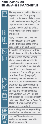

Can't speak for the -4 or -9 canopy. Here's a picture of how the spacers work on an -8 canopy. For Sikaflex 295, if I remember correctly, the entire seam has to be spaced. That information is backed up by their installation guide. Here's an excerpt straight from Sika:
BOND LINE THICKNESS
After it has set, the adhesive remains flexible. However, if too thinly applied, the adhesive may shear due to the changes in dimension caused by differences in thermal coefficient of expansion between the glazing and the superstructure and also the natural flexing between the glazing and the window frame in the varying sea conditions. Sika’s dimensioning guide provided adjacent to the appropriate procedures determines the depth of spacers required to be placed within the adhesive to keep the distance equal to or greater than the minimum depth required to ensure the reliability and longevity of the adhesive and the bond.
In theory, this provides a flexible bond between the canopy and the frame and if properly fit, should eliminate any stress points.

"Place spacers in position". 1st line from the manufacturer of the product. :confused:
This is not a glass windshield, that's why you use the marine acrylic instructions. They have a different product for glass. Spoke to them at length prior to gluing mine on and after 5 years, 400 hours in extreme hot and cold temperatures, no cracks, no separation, no issues.

No offense Mike but why would you completely disregard the specific instructions of the product manufacturer?
Did you use the Sika 209 primer or something else because it’s “not needed” or “it’s just plastic”?
Here’s one of the Sikaflex 295UV guidelines:
BOND LINE THICKNESS
Notice where it says “ if too thinly applied, the adhesive may shear....”
If you use the required spacers there is no way you can end up with a section where it’s too thinly applied.
