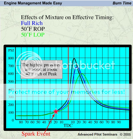

Now we're getting somewhere. The subject is break-in (post 33, paragraph 4), meaning the goal is to generate ring pressure. When quantified, we see there is no significant difference between knob twiddling on climb out and just leaving the knobs alone and flying the new airplane...except for the much-maligned ICP, the source of combustion ring pressure.
During break in you want less of the peak and more of a broad area under the curve to give you better break in. The graph below is generated from
real data and plotted nicely for classroom use. Take a look at which has a lower peak ICP but a broader and wider range of average pressure. So tell me which is better Dan, a higher MEAN effective pressure or, higher peak pressure? Higher CHT or lower CHT? Cleaner or dirtier combustion chamber and oil? One operation as all the good things and less of the bad. (NB: 80dF LOP would be better, this graphic is produced to show the traditional thinking 50LOP/50ROP comparison. It applies here full rich Vs even 50dF LOP.)
As I said before, either do it full rich or 80dF LOP.

Proves the point, but she is a pretty sharp operator I guess, so how about an old retired airline guy, took him flying today, got him to do a BMP, never done one before, and exactly like Kreisha Ballantyne he landed bang on target at the appropriate number of degrees LOP. I mean bang on with huh accuracy, and so did Kreisha and everyone else I have asked to do it. Close your eyes and pull back, under two seconds, eyes open.
And here you are complaining about eyes down in the cockpit. Please, the BMP means NO FIDDLING, and maximum eyes outside. In a busy terminal area this is what we teach, no fiddling just a BMP and park the engine in a safe place. Works for turbo or NA guys. Zero downsides. Maximum SA.
