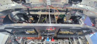

Aerotronics work of art. Only thing mounted to sub panel is the avionics back up battery.

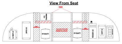

Found the vans 3d file, and the Garmin 3d files, and in Fusion made a few simple blocks (IBBS, VPX, CO monitor) to play with locations in the virtual world.Screenshot 2024-11-24 at 11.26.12 AM.png
Steinair provided recommended subpanel population diagrams to go along with the RV-14A panel that they did for me.
Which I was successfully able to build to
and has been a delight to fly behind ever since

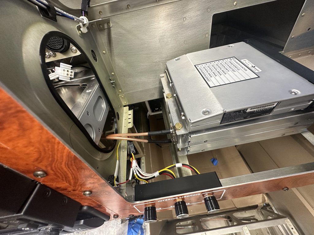

It will not be easy to reach things there behind the subpanel.
A nice option would be to use https://advancedpanel.store/products/rv-14-map-box-ribs-pair to stack audio panel (you already have it there, probably mounted in some other way) and transponder on top of it. In this setup, both can be easily pulled out through the panel opening once you unscrew the right GDU.
Since transponder is longer than the audio panel, back connectors on both will be accessible from below. Also, the space behind the transponder in this setup leaves sufficient space to place the ground block there on the back side of the firewall.
GDL can then be mounted on the small removable rails between the panel and subpanel on the passenger side (the space for some reason is frequently used to mount a huge transponder that honestly barely fits there) - this will ensure the proper GDL orientation.
The only stretching I had to do while installing things this way on my build was to screw transponder/audio trays to the ribs. Even riveting ribs to the firewall was a one person job.
A nice option would be to use https://advancedpanel.store/products/rv-14-map-box-ribs-pair to stack audio panel (the you already have it there, probably mounted in some other way) and transponder on top of it. In this setup, both can be easily pulled out through the panel opening once you unscrew the right GDU.

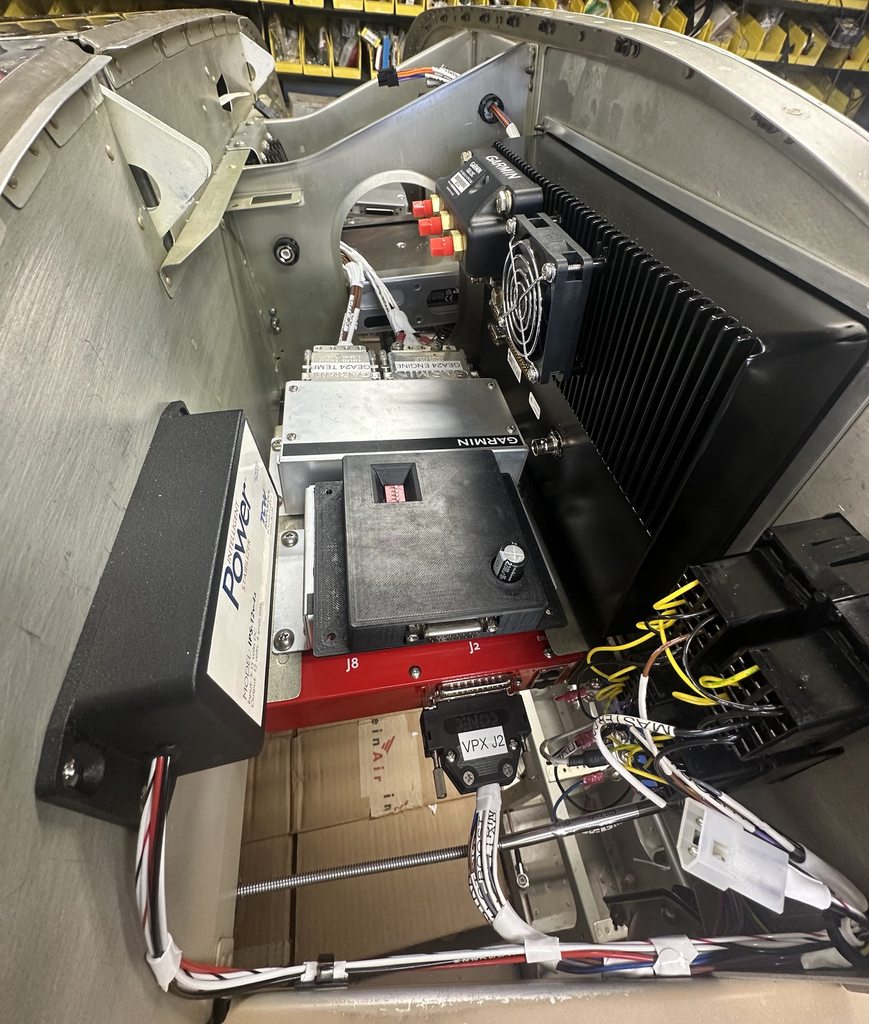

Sorry but I don't have a good picture of my current configuration. But to let you know, I did mount my TCW IBBS backup battery in the glove box area and it is a nuisance getting too if I had to remove. The TCW IBBS connector is located in the glove box opening and is accessible. The small access holes located on top to the forward skin (if installed) offer an access point, but it is still awkward getting to the battery if you needed to uninstall or use to access that area. Unless you are mounting items directly in the center area behind the radio stack, anything will be troublesome. Routing wires or even accessing wire harnesses would be very awkward in your layout in my humble opinion unless your items were mounted upside down so that you could service from the bottom cabin area. But then you have to deal with the peddles. Accessibility is the key issue in my humble opinion. Good luck with your build.
My approach when I built the 10 was to wait until things were closed up before doing the mounting and installs. My logic was that if I could install it that way then I could service it later. Seemed like a good idea at the time but I did spend a lot of time working under the panel to get everything fitting nicely.
This go around on the 14, I plan to do any mounting system done prior to closing up, and I also plan to install the OP-43 access panels for future servicing. Not having the fuselage in front of me I'm guessing I could do a rail mount system and/or mount on the subpanel so both sides are accessible if need be. Or like in my 10 if I pull a G3X or panel I can get back there too.

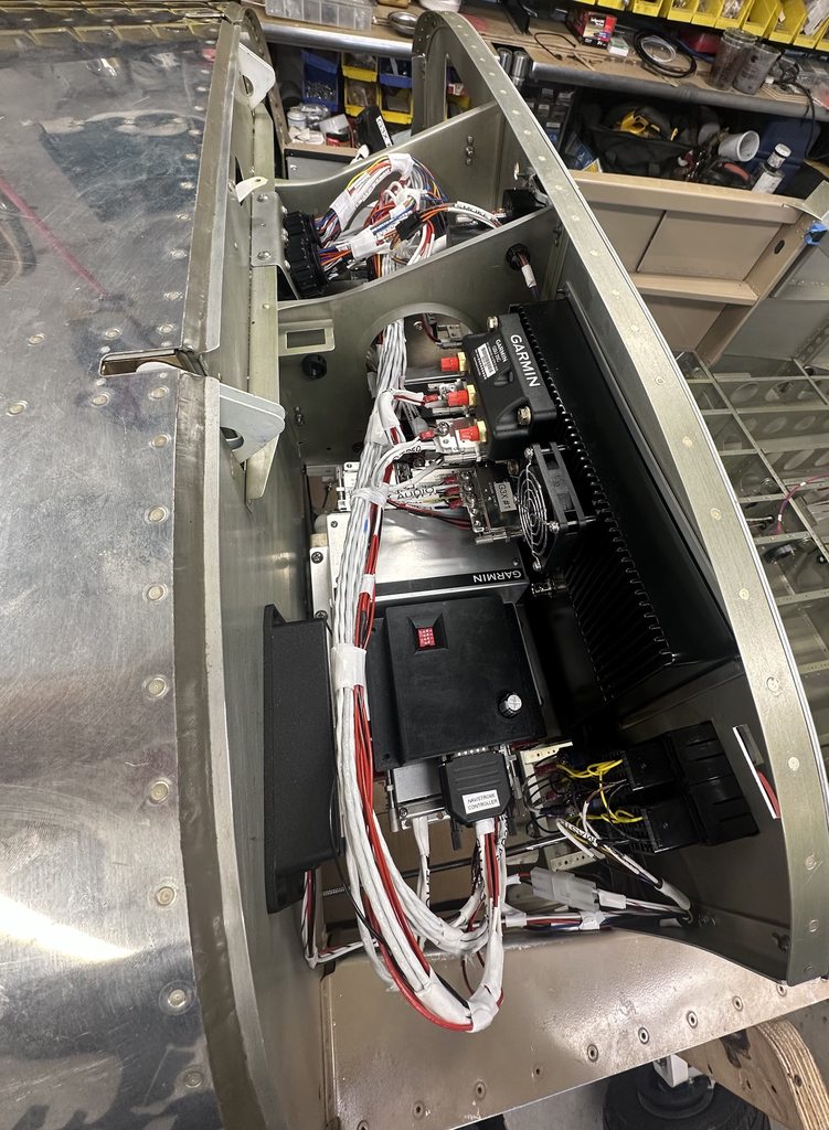

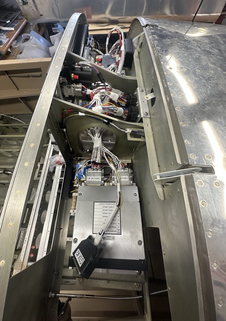

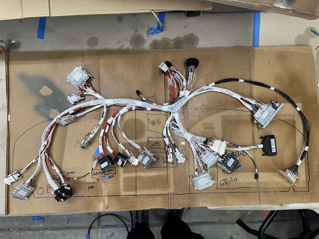

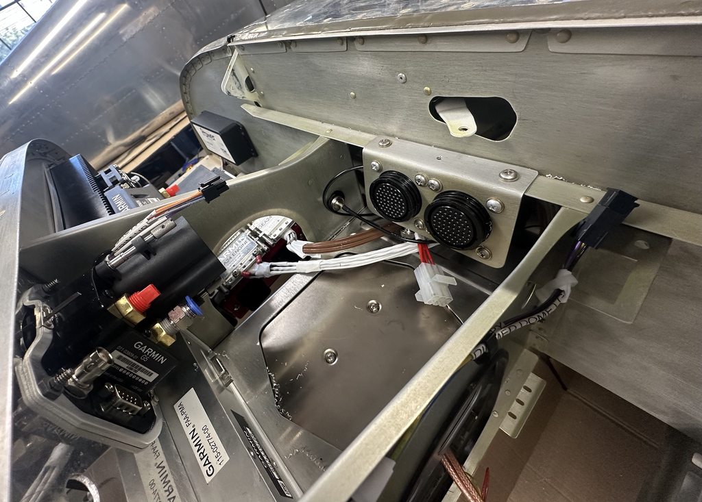

This is my second time wiring an RV-14 and I really tried to make it as serviceable as possible in the future. I built the harness on the bench, it can be removed from the aircraft in 15 minutes for any future maintenance or modification. All of my avionics are forward of the sub-panel and can be accessed from outside the airplane. I never had to get inside the airplane or under the dash for the install.
Harness laid out on bench
G3x, VPX, GEA24, GAD 29, GSU 25, Voltage Stabilizer, FlyLeds Strobe Controller
Gnx375, GMC507, G5, 2x Cannon Plug connect to the fuselage harness and molex carries higher current appliances
GMA245r, 2x GTR20. Wires for a second g3x but I prefer the ipad in a Guardian Avionics mount running foreflight
with wiring harness installed
