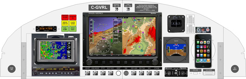

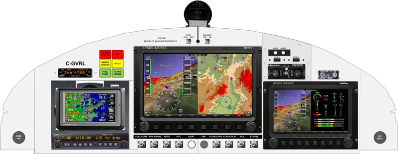

What's one to do after 25 flight hours on a new Rocket? Redesign the panel, of course:
As-built:
Now:
This required purchasing a new SV-D700 and pedestal mount compass. I moved the intercom, changed my system access connector to separate audio and data connectors and added a second USB port. Barely got everything to fit. There was no room for any extra Dynon knob thingies, so this is it.
This is a VFR OTT/Night panel, but Aera could be removed and a GNS navigator inserted. Has heated pitot plus alternate static, so IFR upgrade would be 'easy'
I also added a Ram pedestal mount for my iPad mounted to the tunnel. The iPad mini sits just below the panel center in flight.
