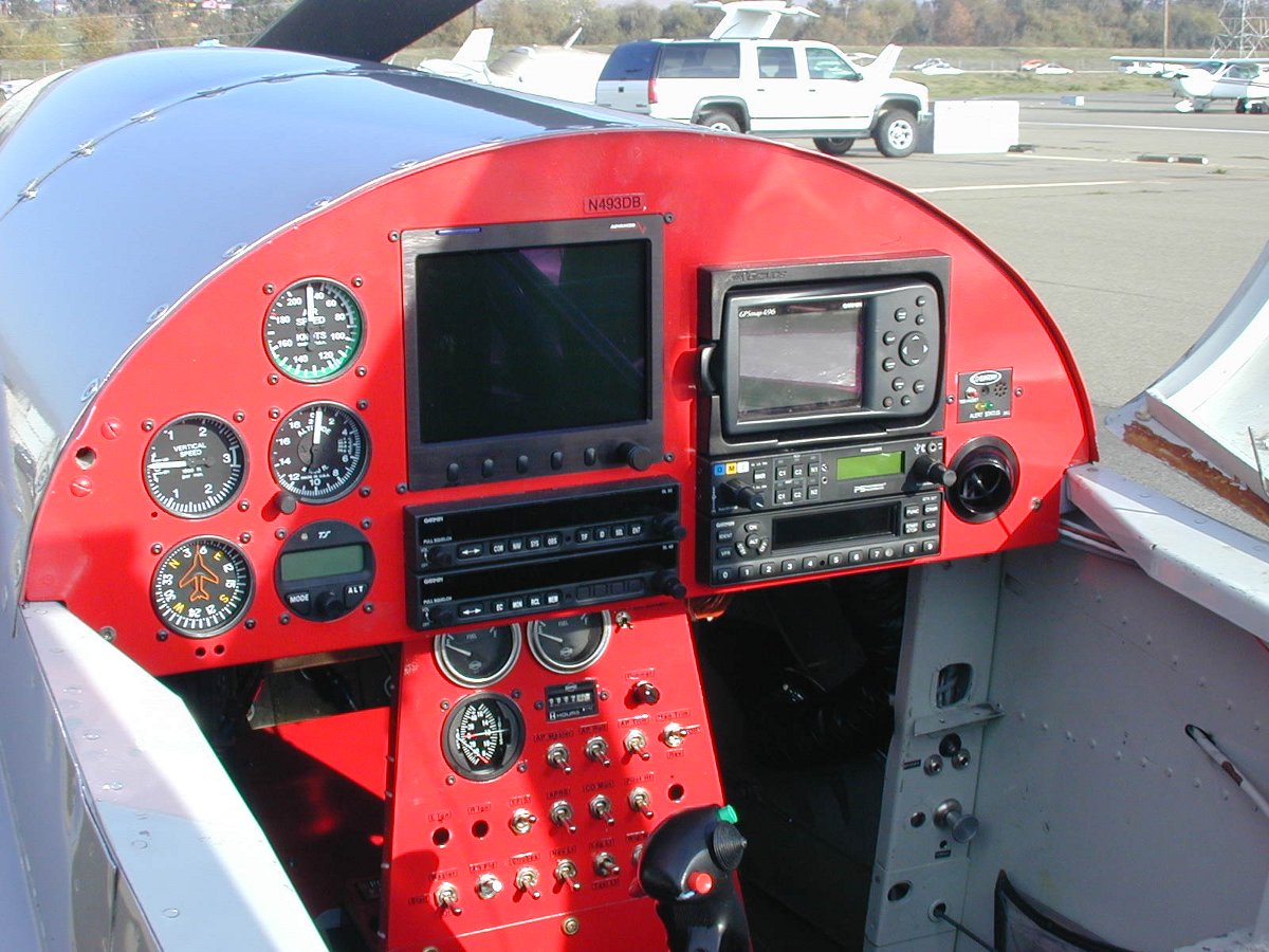

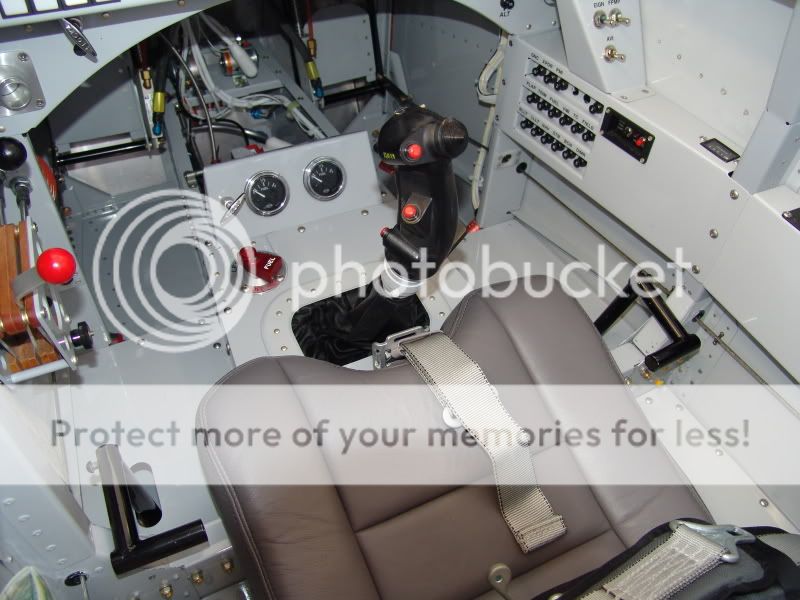

Here are two shots of my instrument panel and fuel selector/fuel gages group. The panel (just finished in this photo...airplane was almost done)
is obviously very simple. Radios are Garmin 250XL and the 397 Xpndr. Vision Microsystems 1000 engine group. The fuel gages "panel" can be
removed for easier access to the battery (just forward). Circuit breaker panel was fun to build. This airplane is just for VFR, upside-down, local hops with the occasional "nice-weather" cross-country trips. When I want to fly IFR...I go to work (!). :)

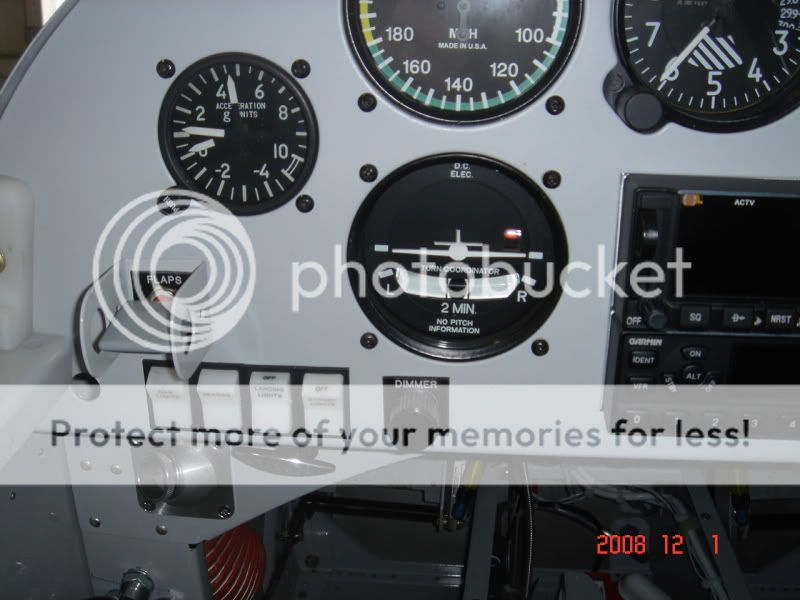

Here's that simple VFR panel of mine, again. I just added a little something to it... Every time I get in and out of the cockpit,
my left foot comes perilously close to that flap switch! Easy fix: I made a little guard for it, out of .063" aluminum.
That kept me busy for a couple of hours...
Question
Kevin,
Looks really nice. I like red, no kidding!
Question; what is the thing on the far right side of the photo. It appears to be a rod that penetrates through the side skin into the cowl cheek extension. Some type of fresh air vent control? I love innovation. What have you got going there?
Again, great looking panel. Let us know how you like it.
Whooops! I thought immediately of the cowl pin on the left...didn't pay attention to the other side - Kevin is going to have to answer that one - I have no idea! :)
I guess I missed Stein's pre-edited post but I think he got it right. It's the copper tube through which the right-side cowl pin runs. The left side is identical. I don't like this mod too much. While it cleans up the exterior looks a bit, it makes stabbing the cowl pin considerably more difficult. I've gotten to where I can do it without too much pain or cussing but it's always a chore.

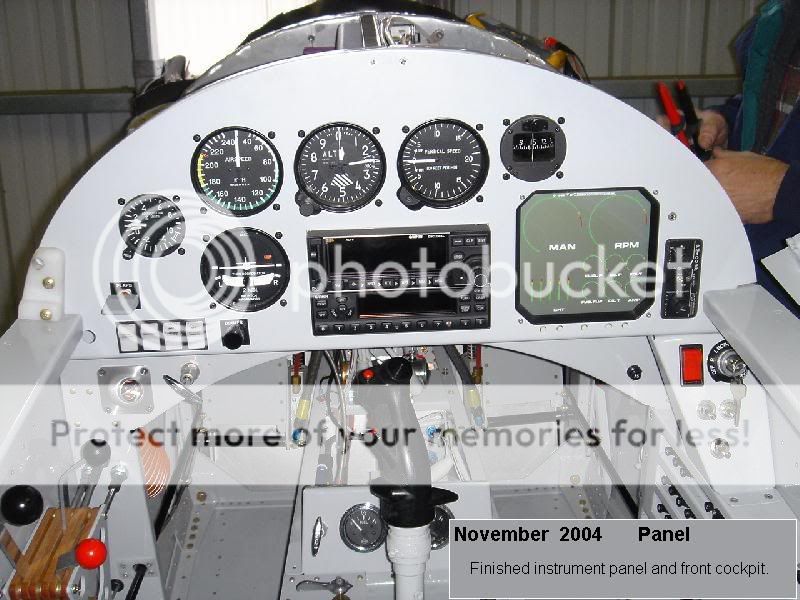

Done!...Finally

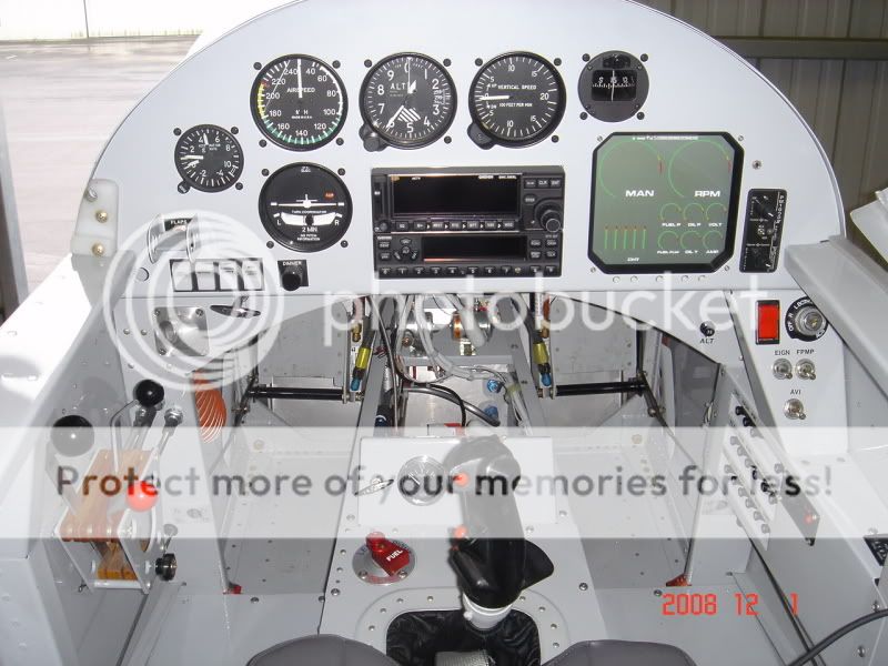

Well, it took a few weeks longer than expected. Something about starting a new job that detracts from more important things like RV's.
Completely new panel. New Side panel with switches and breakers. New center console with a slot that my knee board fits perfectly in. Just waiting to figure out the new interior upholstery colors before putting in the stick boot.
GRT 8.4" Sport with internal GPS, ARINC, and battery back-up coupled to the new Trio Pro Pilot. Garmin stack with SL30, GTX327, and GMA340. IFR capable but not until it's fully tested.

I want to put my radios in the same location. Did you cut the cross bar behind the panel in order to mount you radios. Can you take some picture of the panel from underneath? Thanks.
Axel,
I have two cross braces (alum angle) behind the panel. The avionics are below their level and the aft one is actually raised about a 1/2" using some spaces and AN3 bolts. The SL30 is supported by two vertical pieces from the aft cross brace to the sides of the tray.

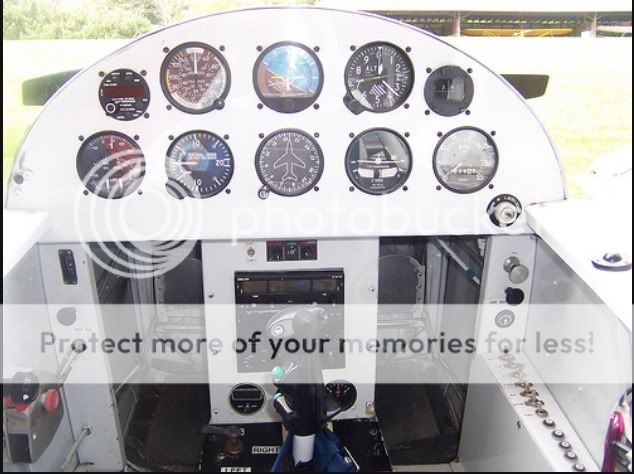

I am buying a 4 which has the magnetic compass uniquely mounted under the panel, attached to a tray where the centre console would be if there were one. I am very happy to see so many photos of panel mounted compasses. Has anyone had any problems with compass errors caused by their mounting location? Were any precautions taken or needed to prevent such errors? Thanks in advance, Slats.
Compass errors
Ours has a remote unit that is mounted just behind the rear baggage wall.
