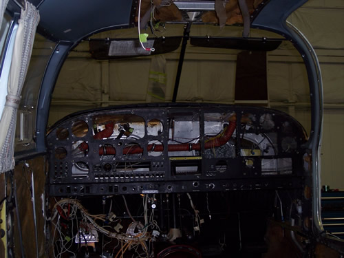

My old panel - Tear down
Thought you might like to see a panel being taken apart. This is the panel in the AOPA Win A Six - as it looks right now. :eek: It didn't used to look this bad and I doubt it ever will again. My wife could only recognize it by the curtain on the left. It wasn't bad before they started, of course after they get done it might look almost as good as my RV-7A when I finish it! :D

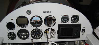

Fuzz Panel
Here Is my panel,
Very simple just like me. But I do have dual throttle , and pitch only for co-pilot, no mixture, cause there usually dopy, so they cant shut down the engine. if you like the idea I will show you the deal.
