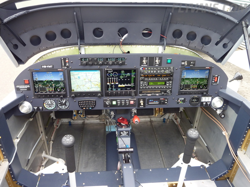

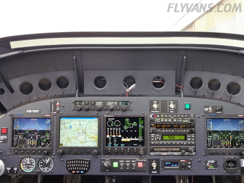

since i last posted quite a while ago,
here's a lit up version of the panel :-)
almost the same level of integration as the g900x (nice job by the way, peter :-) but at a lower cost and with more custom/self-fun-developed stuff ;-)
and with the center console in sight
rgds bernie
p.s. mission is "personal airliner", we know, it's way overkill for vfr... but having fun at it...

Wow...really nice work.
And your console is almost exactly what I've been sketching...low profile, but with a quadrant. Going to have to go spend a few hours reading your site now... :) (Like the low profile but well integrated PC type system as well...)
What are the details on the box on the top? (EDIT: Found it. Nice. :))
VERY NICE BERNIE!!! I love the Vertical Power system and will be anxious to here about all the automation you're able to have because of it.
By the way, what is the keyboard under the map screen for?!?
Awesome panel!!!
- Peter
hi guys,
as you noticed there are a few non-standards in the panel ;-)
the vp200 is obviously "off the shelf" and a even for our mission a bit of overkill, however i would go that route again, maybe evaluating their new stuff as well which wasn't available at the time.
then there's the "mappc" and the "afcu". both are our own developments.
the mappc installation consists of several parts.
mainly the display unit (with two push/pull rotaries and 4 pushbuttons, an sd card reader and a 640x480 lcd screen. all mounted in a case also housing the required lcd hardware, a powerless usb hub for the various subcomponents and a usb joystick interface board to read the pushbuttons and rotaries. it's the unit just to the right of the left-side efis).
the keyboard below is a simple "minikey" usb keyboard originally intended for a playstation controller, it allows to enter standard alpha-numeric inputs plus a few function keys as a large keyboard would (figure direct to waypoint x in the nav software or selecting artist y in the music database)
also part of the installation is a tiny touchpad (ergonomictouchpad.com) which sits in the center console below the panel just above the fuel selector, lets you rest the palm on the fuel selector while operating it.
and the main cpu is an advantech ark-3384 embedded 1.4ghz mobile celeron with a 16gb mtron solid state disk (no hd in that environment!). powered off a stabilized 12v power supply intended for car computing with remote power on/shutdown feature. both are mounted above the left pilots feet between the firewall and the subpanel.
software is a stripped down windows xp as the os (boots in 15s off the ssd!), pocketfms for the navigation / flight plan output, xbmc (xbmc.org) for the media center and the interface for the buttons through the joystick in is my own design using vb.net and the slimdx directinput library.
the afcu is mirroring the interface that airbus uses to the flight director / autopilot. pushing is automatic (nav mode etc...) pulling means manual select. working with rob hickman on the serial interface, he promised to implement that sometime in the next year. so it's not working fully integrated yet. also, most of the actual logic is in the efis software itself, the main function is to overcome the deficiency of having only one rotary button per efis screen. there will be a few logic functions like "present heading" when switching from nav to hdg mode and such.
the unit runs independently of the other (mappc) stuff, architecture is avr based and has its own firmware therefore.
"buttons" are
- rotary for QNH with toggle from QNH to STD and vice versa by pushing
- one button to cycle through the nav src inputs
- rotary for CRS command on the hsi with a pushbutton function.
- timer button for start, stop, reset all in one
- ap/fd button to turn the flight director on or off
- hdg rotary with push for nav mode and pull for hdg select mode
the display segments are used to indicate what mode is active, if it shows a number it's selected hdg, if it shows --- it means the "computer" has control.
- dual concentric altitude rotary with pushbutton. selects the thousands and 100s or 50s, we'll see what makes better sense.
- vertical speed rotary with push/pull function
- lat arm button to "arm" the approach mode, use hdg to intercept a course line etc...
- vnav arm button to arm in the vertical sense, e.g. vertical speed select but ready to intercept an ils glide
rgds,
bernie

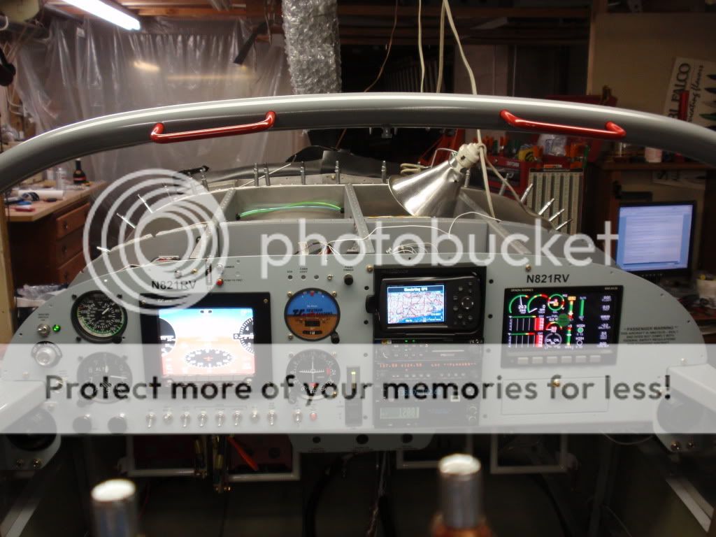

Here's my panel that I have been working on for let's say a long time. Steinair's guys did the harnesses for me and helped me bring everything on-line. It went together well. I back-lite the lettering. This is an idea that I got from Bret Smith and Mike Behnke, thanks guys. Clean and good symmetry.
Dual GRT HX, HS; Dual AHRS; Dual magnetometers; TrueTrak Digiflight II, VSGV; TruTrak ADI w/GPS; PMA8000B Audio; GNS430W; GTX330; SL-40 Comm; GRT EIS4000

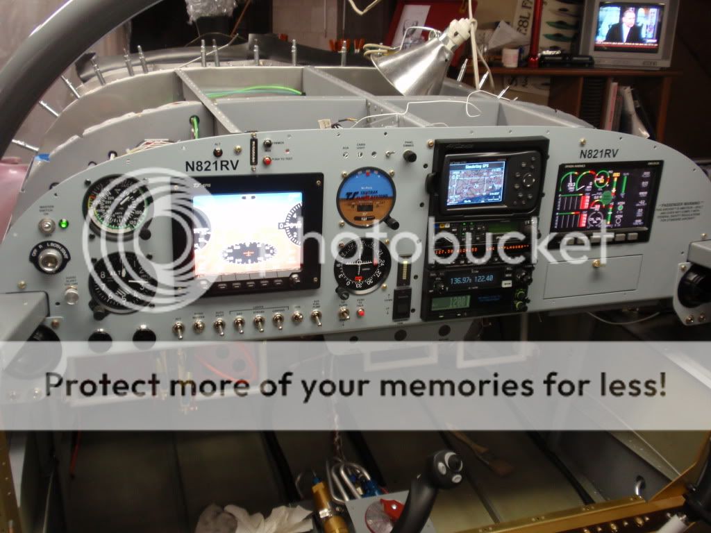

N821RV's panel
Here's a shot of my panel. This has definitely been a challenge, but I'm pretty happy with it now. TT Efis, Dynon EMS-120. Stienair vents. I used the decal pro method for the lettering, like others have said, a bit of a learning curve but after a bit I could zip out what I wanted in about 10 min from typing the decal on the comp to application. My biggest time consuming problem with it was learning to use MS Word to get exactly what I wanted!
Thank you, I just looked at them & they look pretty good. I like civvy looking grips for RV's. Some of the Mil grips are just out of proportion looking.

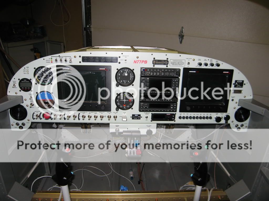

First Look at my Panel
This is the first photo of my panel (and my first time to try and post pictures..bear with me)...The basic design was "stolen with permission" from Paul Story at Steinair...and thanks to Stein's staff for great support.!!!
Dual Advanced, UMA backups, GMA240, SL-30, GTX-327, Klixon Beakers, Davtron Timer, SIRS Pegasus Compass...Not labeled yet!

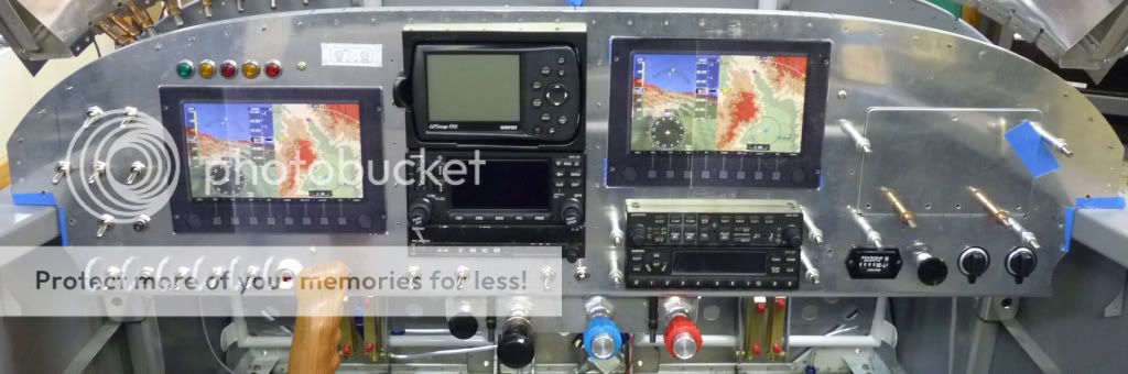

RV-9A Panel
All holes cut. I still have to buy Skyviews and ELT. Wife is pilot so 2 pilot operation was considered during panel layout. Garmin 196 to be replaced with 496 before flight. Now to take it all back apart for paint and riveting.
