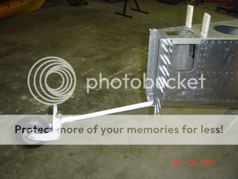

7A Finishing
Status Brantel #72823
Everything is back together and ready to rivet.
The spring mount area was easy this time to go together. I put the bottom skin together with the spring mount skin and then added all the bulkheads and the J stringers. I then put on the side skins one at a time and everything just fell into place. Much easier than trying to wrestle that area together after the side skins are on.
Brian, Looks great and that costume is cute! I don't know if you read about my F-779 challenges in another post, but I had to order a new one. Sigh. I was amazed to find that Van's has really improved the bends on this part since I received my fuse kit a little less than a year ago. The improved bends made the entire area go together sooo much easier... it was amazing. The new guys got it so easy! :) Take a look at the difference, old (bottom) vs new (top).

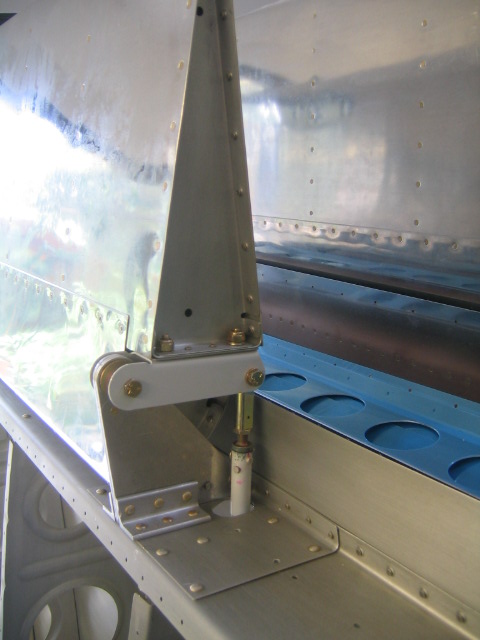

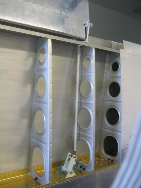

Bellcranks and pushrods done, Ailerons (more or less) installed:
finally found my camera. Here's a shot of the qb left wing with bellcranks and aileron pushrods installed.
Closeup of the bracket/pushrod assembly on the aileron. Thanks to everyone for the tips on riveting the pushrods in the c-frame!
these ailerons will have to come off to install the aileron braces, of course. I just wanted to see the linkage working.

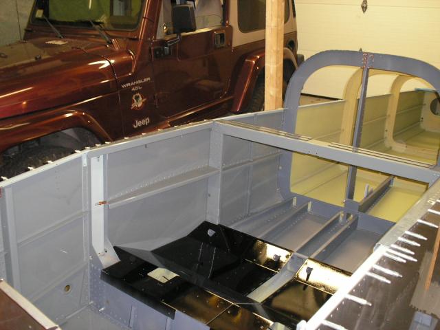

Status Brantel
Wow what a great long weekend for progress on the RV!
Started by notching and fitting the longerons for the first time, finished riveting the center section bottom skin on, mated the center section to the rear fuse for the first time, clecoed on the side skins, drilled all the bazillion holes in the longerons on both sides back to front, drilled the side skins and bottom skin to the rear fuse, drilled the side skins to the bulkheads and side seat ribs, and made two conical bends and drilled the corner baggage ribs to the side skins.
WHOHOOO no cracks on the conical bends!
I guess I can declare my fuselage kit "done", since I have no parts left to work with until the finish kit gets here.

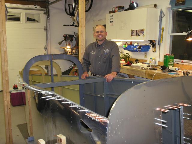

Status Brantel
Spent all my time this weekend finishing up the fitting and drilling of all the parts of the forward fuse. I am now complete will the fuse up to the pre install of the brakes.
If I had it to do over again, I would throw out Vans directions on how to fit the lower and aux longerons. If you do it their way, you could and most likely will run into problems with the parts shown here. The spacing between the two longerons is critical to get the gear leg doubler, fuel tank attach angle, and the bulkhead shown here fitted properly. Vans method leaves too much margin for error which causes allot of work to get these parts to fit.
If I were to do it over again, I would use these parts to locate the lower and aux longerons instead of the centerline in the hole method.

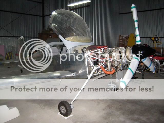

N454CH Gettin' Close
Here's N454CH about 3 weeks ago. Since this photo the exhaust hangars are done, all the engine hoses are installed and a prop spacer has been installed.
I can see the light, and now I'm fairly sure it's not a freight train.:D

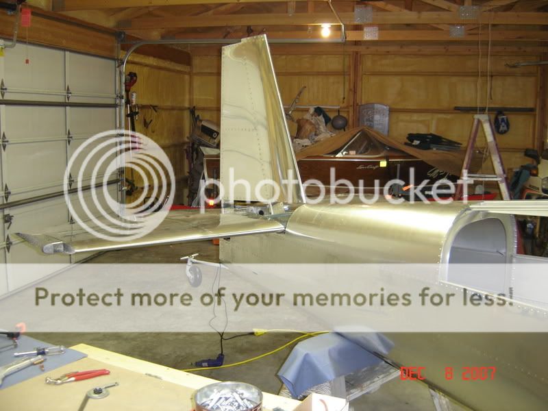

I have a vertical stabilizer
You can see my makeshift "retractable" paint booth in the background. I'm working in a small shop (20'x14') so I have to be kind of stingy with space. I have velcro straps pinched between the wood strips that hold up the plastics walls so I can roll things up and out of the way. There is a window on the back wall of the shop that I use for exhausting fumes.
