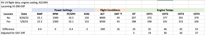

RV-14 cowling louvers
The louver set is from GAMI/TATI. It is what they use on their Cirrus turbo-normalized engine. Don't have PN, but you can just describe it and reference my airplane if you talk to them. There are other generic louvers offered out there. Here is some very quick before and after flight data at similar altitude and power settings.
Jonathan, can you confirm if it’s one of these? (See link below). You stated that the one you’re using is for turbo-normalize, but both of the ones in the link are for non-turbo. I couldn’t find a part listed for the turbo-normalized. Also, were you able to purchase just one, or did you have to get two?
https://www.tatparts.com/category/CirrusSR22Misc.html
First and foremost, your plane looks absolutely fantastic! Well executed and congratulations.
I am intrigued by the louvers as I covet your temperatures. Are the temperatures without the louvers with the cowl (cooling) flap open or closed?
Add-on questions.
I also like the cup holder forward of the fuel selector. That requires a vertical circuit breaker panel setup. Do you find and issues with that setup vs a angled power panel? Mostly I'm thinking circuit breaker accessibility. In plain English, can you reach the breakers?
White lightning power. I've been looking at them. I suspect that you have a connection point. Would you be willing to share a picture and how you set it up.
Thank you in advance!
That looks like the correct part. I only purchased one, not two. Probably need to ask about that. Also, none of the other hardware. I am probably mistaken about it being for the TN Cirrus. I have done several projects with GAMI and when discussing the high temps, they recommended trying this louver set. Obviously worked well.
