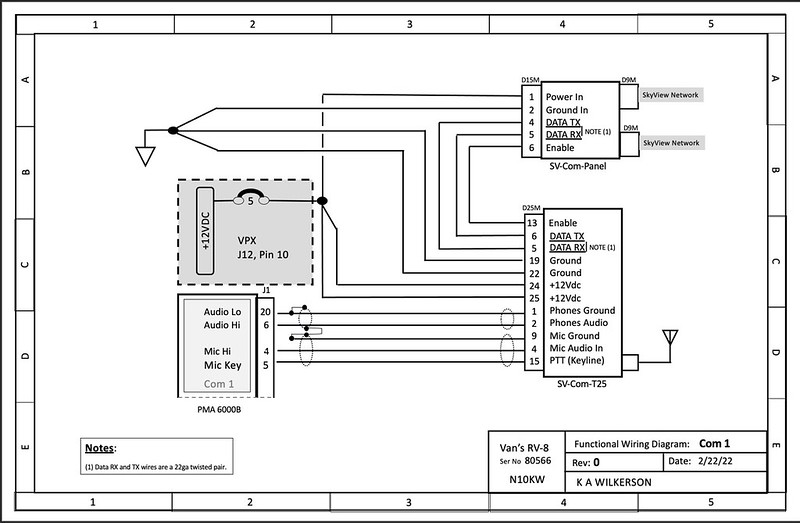

Here's one of my wiring diagrams (I'm just starting on this part so, this is the only one I'm ready to share):
not just P1001
from post #34 said:
leok,
You show multiple independent power feeds to GTN 650 as if it had redundant power inputs like G3X but it does not. Power from a single source should go to both pins 19 & 20 on connector P1001. A single pin cannot handle enough current so Garmin uses both pins 19 & 20 simultaneously. Same goes for ground wiring. Both pins 77 & 78 need to be connected to ground. The installation manual has a typical installation interconnect figure that would be good to review.
Note this applies to P1001, P1003, and P1004 of the GTN 650/750. In the case of the comm, P1003, three terminals are used because the comm draws more current.

Hmm. If it's a functional diagram, do you need to show the power and ground wires?
Also, if pairs of pins need to be connected together, you could show that right at the box, not at a distance.
For what it's worth...
For the first question, the idea was that if there's a gripe on COM 1, I could look at one diagram and get a quick visual on how COM 1 is wired. I'm comfortable with wiring diagrams. And, with so many different ways to handle terminations, I try to keep the diagrams looking like the way I expect to see the physical wires in the airplane. It may not meet all the professional technical standards. But, I hope it does at least make sense. And, as far as that particular diagram goes, I was very unhappy with the documentation from Dynon for the SV-COM-X25 radio system.
As for connecting pins together: I was never 100% clear why a piece of gear would have two power pins and two ground pins that just get connected together. But, I thought I'd read somewhere years ago that the idea was to have both wire runs terminate at the source/ground stud.
I'm not an engineer, draftsman, or technical writer. I'd love hear any suggestions you have to improve my project.
redundancy and connector current capacity
Two reasons for dual (or triple or more) connections that I know of:
  • Redundancy:
    • For instance B&C shows dual ground connections for LR3 and SB1 regulators, one to connector and one to stud on regulator case.
    • My FMEA for the electronic fuel injection I am installing leads me to install redundant grounds for both the computer and the driver sections of the ECU.
    • Grounds are independent where they connect to the aircraft.
    • Failure of one ground is benign in flight and not detectable at preflight so physical inspection at annual inspection is called for.
  • Connector pin/socket current capability:
    • Avionics manufacturers use multiple pins for power and ground due to current capacity limits of individual pin/sockets. These are not diode OR’d unless specifically stated in the installation manual.
    • Ref Bob Nuckolls Conducting High Currents through D-Sub Connectors, the size 20 (awg max) pins used in D-sub connectors can share a load better with pigtail wires added as resistors to balance the load through the pins, 12” of 22 awg or 20” of 20 awg.
BTW pin/socket current capability is not a set number. Like wires in a bundle, multiple pins carrying current in a connector generate heat and reduce rating.

Correct. Most of the Garmin devices have two power/ground pins for redundancy and so can source from two different locations such as maim/back up power busses. Either or both can supply the power separately or together (for a seamless transition if one source is lost)
So far as I am aware, only the GTN 650/750 has multiple pins to carry the full current load, so requires all legs to be live at the same time. Therefore, only one power source (such as a multi buss system) can be connected. I chose to run separate wires back to the main buss rather than tie the pins together with a splice or jumper. The power wires tie together at the buss.
Running power as if the power sources were redundant was an error I caught early enough in the diagram stage to correct without needed to rewire anything. I did add e-buss power feed through diodes as a redundancy, but don't recall if I ever updated the drawing to 'as-built' status on this item.
Since my skills do not include computer programs for laying out wiring diagrams, my method is decidedly old school: pencil and paper
If you see anything worth changing, pipe up, please.

Standing on the shoulders of others
Boundary Conditions:
Electrically dependent aircraft
EFII (came with Titan Engine)
Monkworkz Back-up gen
This is my proposed single-line functional diagram; no connection points, wire sizes, etc. Only power distribution architecture.
I've bugged a lot of people and I appreciate all of their help. If anyone sees any discrepancies, let me know. I was always a believer but now I've been fully baptized in the Froehlich church of redundancy and symmetry. This is 99.99x% his knowledge and experience. I've stated before, this or similar architecture is appropriate to more aircraft than is initially obvious; even legacy Fuel and Ign aircraft. I believe the redundancy pay for itself in relatively short order by not purchasing dedicated expensive device back-up batteries. Anyway, have at it. Constructive advice would be appreciated.
  • Power Dist SIngle LIne Functional.pdf
