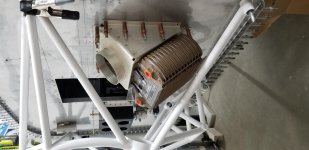

Hey all,
I am installing piston skirt squirts in my Parallel Valve, IO-360 engine and from what I hear, I need to change my oil cooler from the baffle mounted style to another type.
I am aware of the Showplanes style, but am leaning towards the firewall mounted RV-10 (VA-186) setup.
Questions:
1) does the VA-186 fit on the RV-7 firewall adequately?
1b) if so, pictures would help in positioning it correctly. Please provide...
2) In keeping with this RV-10 mount, I plan on using the EA OIL COOLER 20006A with it, as provided from Vans and would like to know if anyone with this setup is willing to share empirical data with regard to oil cooling performance.
Thank you in advance.
:) John
Well, ain't no -7 (almost), nor a VA-186, but a Positech P20002C, might give you some idea. The cooling was too effective, and I've since installed a shutter which works pretty good.
Finding real estate on a firewall is usually the bigger challenge, but I would never install an oil cooler on the engine baffles.

My 2 cents...I tried to do this but I could not get the SW8432R to fit on the FW with the mount. There isn't enough room to fit everything without serious fw point relocations. Many may say "sure it does" BUT those are mostly -A models. The -A model engine mounts are trussed differently than the TD's, changing the option of a FW mounted OC tough to accomplish. I finally mounted mine in the stock location off #4's rear baffle. Yes the corner has been reinforced to aid in crack prevention.
attachment.php
attachment.php
It’s a tight fit but worked on a angle for me.
Here’s how I did mine. I can control the temperature in the winter to run at 180F and in the summer never see more than about 190F

Here's mine
For my 200HP, IO-360-A1B6 (Angle Valve - Piston squirter equipped) I mounted a SW 8406R on the firewall. After a couple of flights, I wanted a bit more cooling margin so I upgraded to a SW 10599R -- I just had to remake the diffuser.
...Pics...

Firewall Oil Cooler
This is on my 8 . 13 Row Oil Cooler on its own mount .

My oil cooler is mounted on the firewall with the two ports facing inboard. On the firewall side, a simple aluminum angle mounted to the firewall will provide a nice shelf to mount one side of the oil cooler. The engine mount with an Adel Clamp provides the other side with stability with a couple of fabbed aluminum angle pieces.

Red RTV seals the inlet duct to the cooler. Saran Wrap is a must. After it cured I trimmed off the excess with a razor knife. Another consideration was the hot air coming from the heater valve when the heat is off. To prevent flooding the area where the cooler is now located with hot air I bent up a little box out of thin stainless to deflect it down towards the exit.

Dave, at a minimum you'll need rub protection on the motor mount tubes. A little oil, a little grit, and the wires in SCAT will do very bad things. Looks like there's a control cable against the SCAT also.
Your install and Don's provide an interesting comparison in the same application. Please, take this the right way, but Don's is very good, and, well...
It's about the details.
A long length of SCAT with bends won't flow as much air as its diameter suggests; the effective diameter is much less. SCEET should be little better because of the liner, but not a lot.
The entry from the plenum should have a radius, a bellmouth if you will. Again, a 90 degree edge reduces effective diameter.
The same is true at the approach to the cooler face. A diffuser like Don's won't suffer flow and pressure loss, as the flow should remain attached to the walls, expanding and slowing with increasing face pressure.
Put it together. Don's fixed diffuser on the oil cooler means the hose section between the motor mounts tubes doesn't move. The smooth inner surface of the entire assembly means minor flow flow losses only. A short length of SCEET would also be fine from the standpoint of flow, but the wires might be an issue.
I'm not saying the droopy SCAT and 90 degree tin won't work. The cooling requirement varies with engine choice and climate, so it may be fine with little more than a length of split rubber hose zip tied around the motor mount tubes, or maybe hanging it on a large Adel. That said, a quick scan of your build log says you can do glass work, and it's a lot easier to build it now than fix it later.

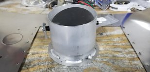

Ashley,
Looking at your pictures a bit closer now, I seem to notice a vane inside the VA-186 mount. Is this a Vans part? I don't see one on the plans.
I am guessing that you fabbed it up on your own. Am I correct? It seems like a great idea.

Oil Cooler Tuning Vane
Hi John,
Yes there is a tuning Vane in the RV-10 Oil Cooler. The part was originally from Airflow Systems as part of there RV-10 2007X Install pack.

Along the lines of what DanH suggested - I wasn't happy with the sharp/tight transition from the back baffle wall into the oil cooler duct inlet. I think I measured a radius of < 1/16" with the generic aluminum flange so there is some airflow separation at the transition, effectively reducing the inlet diameter.
I attempted to make a fiberglass "velocity stack" to make a better transition...results in attached pictures.
Unfortunately, the temps at this location are really close to the materials Tg° so it gets soft. I think the next step is to machine my own velocity stack, or buy something from one of the speed shops and adapt.
Cheers!

Hi John,
You can easily make your own with some scrap .032. The goal is to split the airflow in half from the intake to the oil cooler face. Bill found during testing there was stagnant air flow at the top of the RV-10 oil cooler mount and the splitter went a long way of correcting the problem.
In the photo below, follow the vertical rivet line and you can see how the splitter goes from the round intake all the way to the oil cooler face.
AM-JKLWYg3Ak_7SSyUw5aIcmbdbGYOsa7mAthHISNogaiLhkzdVLyAxRDTD67J6fsOtv_LgstjTed0bm3C6tshAv3fck-ixZMxMMOtlHJDaA8-qv_od1SD8MtoGr738iXBFG6yeOM_jLAqAO483iHVJwC1_o-w=w678-h903
What kind of red sealant is in the picture?
Cheers!

Fascinating individual solutions. Details are important. This is a pet subject of mine. The AVERAGE (1st attempt) installation for cooler air in/out 15 yrs ago not as good (on average). Installations on new builds are improved. Group knowledge is being gained and incorporated. As well as different innovative variations and solutions are being made.
1) Directly hanging cooler off engine baffle unless extensively braced is a recipe for cracked baffles or cooler flange. Not saying it can't be done, but I've been there done that. Not a fan. Remote oil cooler mounting (not vibrating) is my preference.
2) People used small Dia. SCAT in the past (3" for example). I was ranting 15 yrs ago you should use Approx. 4", typically. Dan's comment about smooth flow is correct, but may not make much difference, but does not hurt. VENA HTD (SCEET Equiv) or VENA MT (CAT Equiv) have smooth inner liners. The MT (black) is half the price of SCEET (red). The inner liner not as much for flow but to keep wire from being ingested (if it broke off).
3) The duct (hose) to cooler transition plenum (like Van's metal box design) were not great, and right angles not great either. Can it work? Yes for some installations. Now builders are making beautiful smooth plenum transitions, far better. Again 15 yrs ago I was ranting about this.
4) Cooler exit air. Having the cooler exit in a lower pressure area is golden, like lower cowl near cowl exit.
Now with fire breathing IO390's oil cooling is even more critical. Well done Gents.
Fire Barrier 2000
Hi Fabio,
Yes, Fire Barrier 2000 can be used to seal the gaps.
(Usually used around any firewall penetrations)
Any high temp sealant can be used.
The goal is the same as with the baffle seal to to ensure that ever available air molecule carries some heat away and does not escape with out going through the oil cooler :)
