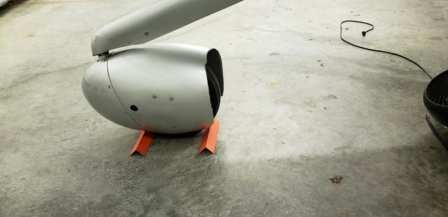

Cirrus and Van’s have Service Bullitains on tire pressur to help reduce nose wheel shimmy. I run mine about 5 lbs less than spec with good results. FYI, Since this is dated back in 07 there is no mention of the -10. I read the Cirrus SB which also addresses the same issue and recommendation with the nose wheel.
