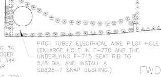

For the 7 you drill a hole about couple of inches from the edge of the aileron push tube hole at about the 5 o'clock position. It's on one of the prints. I imagine the 8 is similar. Fair warning; if you do it that way by the time you get it stuffed full of wire it's too small for most connectors to fit through so in that case your connector would have to be in the wing root area. or go with individual ring terminals or something like that so you can feed wire through into the fuselage one at a time.I have the same goal- want to keep the project at home as long as possible and a quick final assembly at a future hangar some day.

Thanks! After I posted I did find a reference OP-11(this is for the '8 which I imagine is similar to '7), which I think is the one you are referring to? Could not find a plan reference for the pitot line into fuselage though... Also I see on some online build log pictures alternative locations were also used... Sometimes I don't know what I don't know... If anyone is cringing, feel free to speak up - always better to know before I drill the holesFor the 7 you drill a hole about couple of inches from the edge of the aileron push tube hole at about the 5 o'clock position. It's on one of the prints. I imagine the 8 is similar. Fair warning; if you do it that way by the time you get it stuffed full of wire it's too small for most connectors to fit through so in that case your connector would have to be in the wing root area. or go with individual ring terminals or something like that so you can feed wire through into the fuselage one at a time.
oops, I was remembering this wrong. I just looked and print 28 for the 7 has you enlarge a tooling hole to feed pitot & aoa lines through. I called tech support and they didn't see why I couldn't add a second hole as I described above(which is basically where you show it on the RV8 print) so that's what I did for everything else. As always, it's probably best to pick up the phone and ask for yourself because as you say, it's a lot easier than un-drilling a hole.Thanks! After I posted I did find a reference OP-11(this is for the '8 which I imagine is similar to '7), which I think is the one you are referring to? Could not find a plan reference for the pitot line into fuselage though... Also I see on some online build log pictures alternative locations were also used... Sometimes I don't know what I don't know... If anyone is cringing, let me know- always better before to know before I drill the holes

We used the stock exit hole for the wiring harness, but supported it with an Adel clamp at that point
