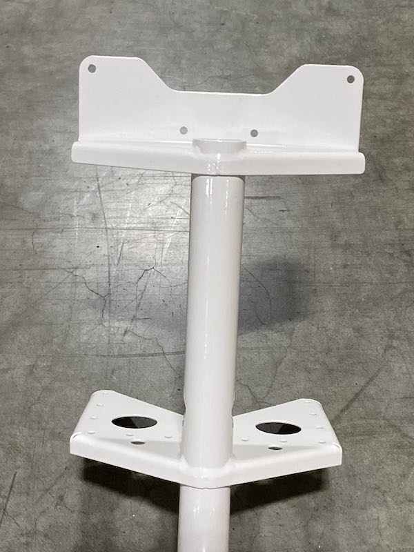

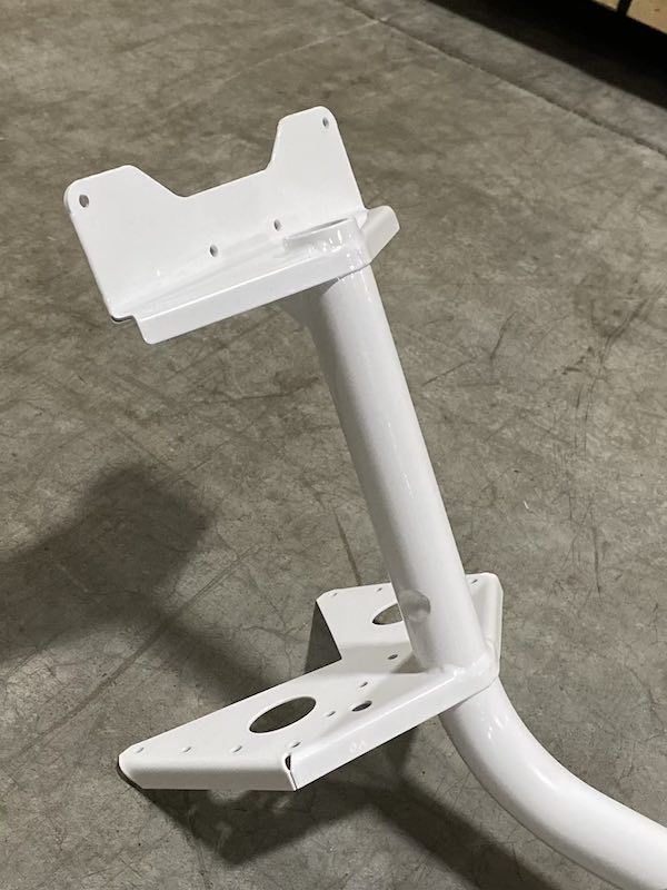

The reason you'll need to unattached the lower engine mount bolts and lift away is that both the existing and new gear legs have a flange at the top which is "sandwiched" between the engine mount/isolators and the firewall. The lower engine mount bolts pass through all of these. You will need to remove those bolts in order to remove the existing gear leg, then back-drill matching holes in the new gear leg's flange from the cockpit side of the firewall. You "lift away" the engine mount to remove the elastomers and insert a temporary wood spacer to allow the required drilling. This is covered in greater detail in the SB text, of course.
When you originally installed the existing nose gear leg, there were full-size holes already in the leg's flange, and pilot holes in the firewall. The original gear leg was used as a drill guide. Now that you already have full-size holes in your firewall, the best method to ensure the new flange is properly drilled to match is to use the firewall holes and tools per the SB to match-drill the new gear leg flange.
Hope that helps. Here are photos of the retrofittable gear leg. Note that the two holes in the upper bracket/flange where the engine mount bolts will be located are not yet drilled - the installer completes that task via the match-drilling steps.
It would be nice to "see" where the "location that is not visually inspectable" is on the failed existing part...
Thanks for the photos....I am at home and don't have the plans at hand, and had forgot about the "upper" part that gets squeezed at the engine mount, had vaguely recalled only the part that bolts to the bottom of the fuselage.

It’s pretty difficult to show you a non-inspectable location. :)
That said, the crack occurred inside the nose gear leg tube, at the welded point where it meets lower flange/attach plate. The crack location is not visible from above or below, as it is blocked from view by the weld and flange/attach plate. Therefore, the first time one would actually be able to see the crack from the exterior would be after failure.

The new gear leg is significantly different than the original one, in that it is double-walled and incorporates a second tube that is located/sleeved inside the external tube. You can see one of four round "rosette" welds in the first photo posted above. Those welds join the internal tube and external tube at a point well above and below the area of highest stress concentration. The additional tube and total thickness, and other modifications to the assembly, results in the load stresses being spread over a much larger area. in addition, the internal tube is unaffected by welding at that high stress concentration location. It is a substantially strong assembly.

The leg is curved where the doubled pipe is used, so it's not possible to simply slip in a piece of pipe. We certainly considered similar ideas but they were not workable, especially for the typical builder. Requiring an RV-12 owner to execute complex fabrication and welding tasks is not what we would classify as "simple." And, as already mentioned we made other changes to the leg assembly. If there was a simple fix to the existing gear leg available that would meet safety needs, we certainly would have gone that route. It's our wish and goal to keep the changes to a minimum (We fly these airplanes, too!) balanced with the need to address any potential safety issues and provide whatever related information we can, so people can understand the "why" aspect of things.

Have any RV-7A or 9A's had to have replacement front wheel strut or forks recalled and replaced?
I would sure like to hear from someone that has already performed the front gear leg replacement and their experience with it, and if any difficulties or advice.
Anyone on the forum done the replacement yet?
Thanks, Greg. You are creating a lot of good will for the mothership by being so open.
I never would have thought the crack would start on the inside wall.
