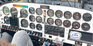

I’m not sure if this is what you are looking for but I have gone through a couple of up grades over the years and am happy where I wound up. I built my 6a with a standard six pack, RMI engine monitor, King 97a radio, and King KT76a transponder. Several years ago I replaced the gyros with a Dynon D10A EFIS. This left an opening below the Dynon where the DG used to be. The next upgrade was to replace the transponder with a Stratus ESG for ADSB in/out. The in information is displayed on an iPad with ForeFlight. I really wanted another radio or a radio that I could monitor a second frequency, plus was starting to see some periodic errors on the engine monitor. A few months ago, I replaced the RMI monitor with an EI CGR30P in the old DG spot. This freed up some room above my current radio to put a PS engineering PAR200B audio panel/ radio so now I can monitor three frequencies. An added benefit is a much better intercom than my old Sigtronics.
I’m just finishing a panel replacement in a Glastar, going full Monty dual screen AFS, Dynon dual comms, etc. But I recently bought a single seat Panther, it’ll be a vfr only fun plane. Like yours it has very basic instrumentation that does not work well. I’m planning an older glass setup that doesn’t require a lot of external devices. It’ll have a dynon d10ems to handle engine fuel flow via red cube, fuel level, egt/cht, rpm, pressures, etc. I’ll put in either a dynon d10a for EFIS and AOA or a d100, a garmin 660, a garmin gdl52 for adsb in, a garmin gdl82 for adsb out, and maybe an older autopilot (I liked the Gemini I had). I picked up a complete, new in box d10ems for 850 w sensor suite, paid 200 for red cube, had the gdl82 in plane already, paid 550 for the aera660, paid 200 for the gdl52 to provide adsb to the 660 and an iPad running FF, just need a d10 or d100 to complete the dash. All in should give me everything I want for less than 4k (w/o autopilot). I’ll modify my current pitot to give me aoa similar to photo. I’ve already got a garmin comm radio and small trig transponder. Not much real estate on a panther panel, think rv3 size!
