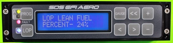

Does sds use egt to lean mixture?
Sorry for a basic question regarding the SDSEFII system, but here goes:
A Mike Busch article explains why not to use EGT to lean LOP for Lycomings. He suggests a technique of quickly moving to LOP using CHT to avoid lingering in an air/fuel ratio that can cause high cylinder stress at higher power settings.
https://www.aopa.org/news-and-media/all-news/2023/january/pilot/savvy-maintenance-egt
Any thoughts on this? Do SDS EFII algorithms use CHT to avoid the “red box zone”? Is this user controllable?
Thanks for clarification.
SDS controls fuel flow and timing. It does have a LOP setting that once set up will quickly change the timing and fuel flow. These are user adjustable. EGT is used by the user to establish that your LOP since it changes with fuel flow so quickly. Once LOP using EGT you can trim (if you have the option installed) the fuel flow for each cylinder to match CHTs if you’d like.
I set up my SDS for LOP at 7500’. This is done while test flying the plane since each installation might be slightly different. My setup uses WOT, push the LOP button then it automatically goes to 29 degrees BTDC and -28% fuel flow. This happens very quickly which avoids lingering in the red box. Then I make minor adjustments using the mixture knob to get it around 30* LOP.
It’s a great system!
Once you’re under about 60% power, the red box goes away. I basically use RPM’s to go LOP. As an example, I take off and climb out at around 2400-2500 RPM at 700 FPM ROP. During this time my fuel flow (i.e. how much ROP I am) is dictated by CHT’s, which I keep 400*f or less during climb out. Once I’m at cruse altitude I’m typically making less than 60% power at full throttle. Once leveled out I do a quick pull of the prop to 2200 RPM….this is typically the RPM’s I cruse at. Before even touching the mixture my CHT’s go from ROP to peak, to LOP simply by decreasing FF by reducing RPM’s. From this point I only have to make minor adjustments of the mixture to get the FF right where I want it. The main takeaway from all of this is that once you’re below about 60% power, you really can’t hurt anything, even if running right at peak. SDS makes a really nice system and gives you the ability to tweak/adjust your fuel and ignition system perfectly.
As Jeff said, SDS can avoid the manual leaning part to go LOP. Press the LOP button on the programmer and you're done once it's set up right. It can simultaneously advance timing a few degrees to minimize the power loss with the slower burning lean mixture.
Easy Peasy.
