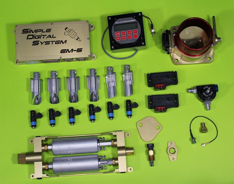

Hi Ross,
Are the injectors shown on your pic below Siemens 650cc?
Correct, however most systems we sell now use a different injector with a narrower spray pattern, compatible with the thread-in injector mounts. They also have a stainless steel body. These Siemens injectors cannot be used with the thread-in mounts.
We use several different injector types, spray patterns and flow rates depending on mounting boss type, engine displacement and hp levels.
